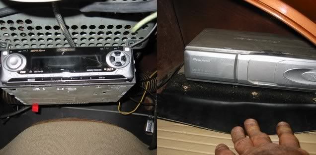

    Added a remote Radio to my 55 under the original Radio with a changer in the trunk and love it. Yes the original Radio does work fine but sucks. Any one els done the same?

      Roy, This is what I came up with many years ago for my 59. It's a remote controlled AM-FM Stereo CD player.
      Made up a bracket that clamps to the steering column just behind the wire harness clamp, along with a "old-school" slide bracket adapter I had from the old 8-track stereo days. Made up my own stereo speaker setup using 4" coaxials to fit in the 6x9 space.
      The best thing is the remote, to control all of the "hidden" buttons etc on the radio. To remove the radio I just unplug the Molex connector for power/speakers, and the antenna cable, then it slides out forward.
      Rich
      p.s. The reason I have these photos with it out of the car.......I removed it for the Regional in January, and haven't gotten around to reinstalling yet. The hardest part is getting at the speaker. I still have scars from those sharp screws up under there!
