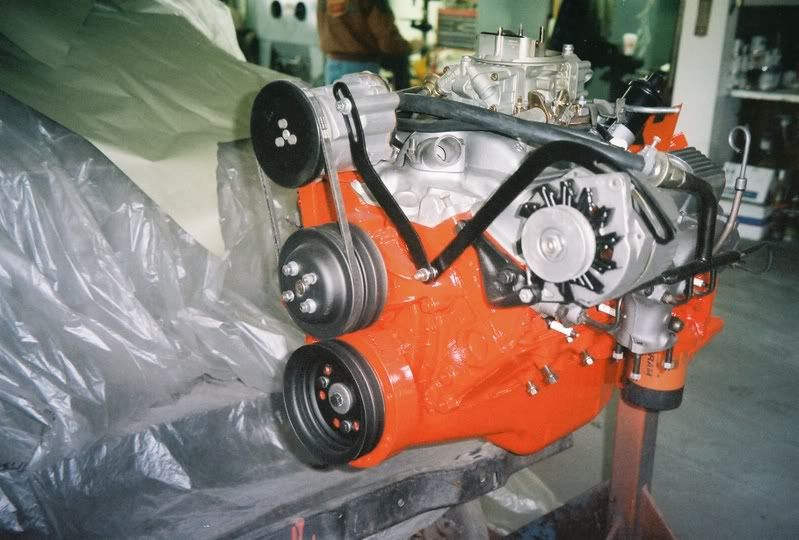

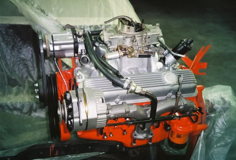

          Roy/Charlie, I also have a '72 LT1 coupe w/air conditioning. Just had it judged at 96.9. However, one of the judges felt the area of the pulleys, brackets from the alternator side looking down from the alternator to the water pump pulley did not look quite right. Did not get dinged but a judge said I should look into it. Do you have a good clear detailed picture(s) of this area you could share with me?

            Jerome, my car does not have A/C However I do have a good photo from my completed engine before it went into the frame,I will try to find it and post as soon as i can

              Jerome, many judges are more familiar with a particular year that they own and when they see something that is different may make a comment like that. On page 21 of the NCRS technical manual for 70-72 "Lower support on 1970 and 1971 cars was an orange stampted steel bracket. 1972 had a lower cast support that was painted semi-gloss black. This explains why it looked diffetent to him. The owner must become the expert on his year to dispute deductions that may be made in error. 72's have many small things that differ from the 70 & 71 years. I'm learning how to post pictures. I have two that I will try to post in a later thread.

                these are the photos i said I would post for jerome, I don't think i was doing things to NCRS standards so I don't know how helpful these will be.

                  Great looking car and engine in your pictures. Thanks for taking the time to post them.
                  PS: How did you re-finish the valve covers?
