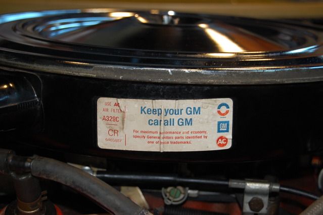

                      Hello Alan,
                      I too am looking for an air cleaner decal. I have a 1970 LS5. We're you able to confirm
                      which of the reproductions was closest to the original?

                        Hi Gene,
                        I have a picture of a nice original.... but I can't find it!!
                        I have to go to work now but will look again later today.
                        Perhaps someone else will post a 70 closed base sticker picture.

                          Hi Gene,
                          Here are 2 pictures of a label I saw at the Altoona Regional.
                          I'm not sure now what year 70-72 it's from???
                          It's certainly very different than the samples I posted. Does anyone recognize it?
