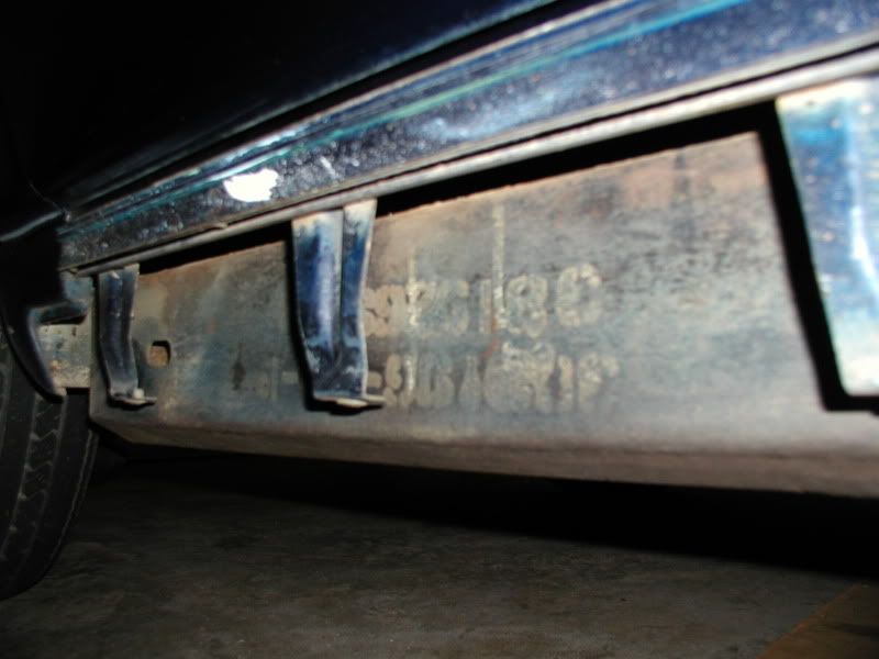

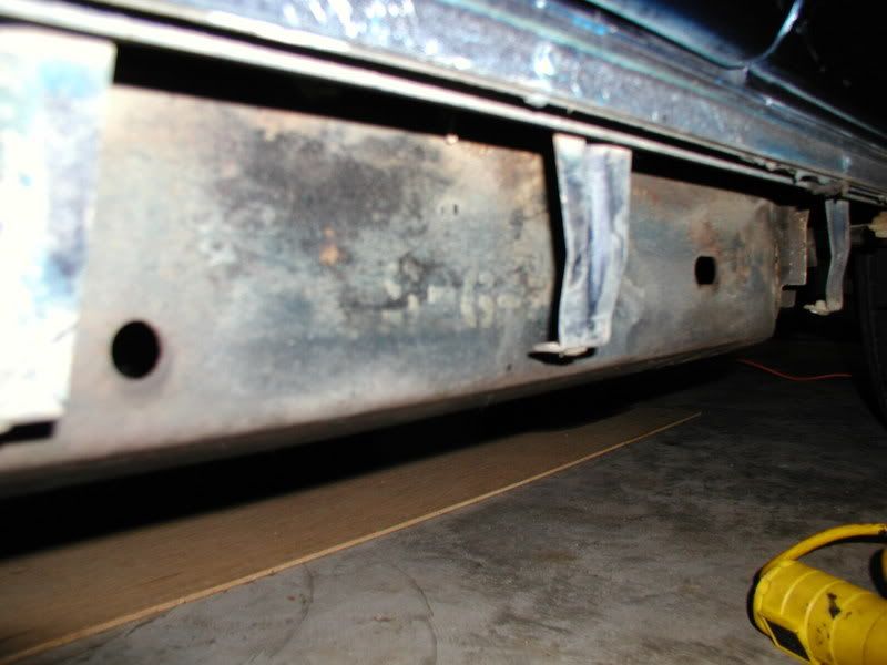

    I have a very early (#347) 1964 roadster with a stenciled date in the area you mentioned. My frame has a 1963 part number also stenciled on it. I was also curious about this dating, but had never posted a question about it before.
    The date on my frame is 2-9-5 - stenciled upside down as you noted.

          This frame has the number 3819263 stenciled on it which my judging guide (4th edition) noted that as a 1963 part number. The other number stenciled on it appears to be 303196-10-P. The frame does have the '64-style e-brake mounting hardware welded on it, so it is not literally a 1963 frame.

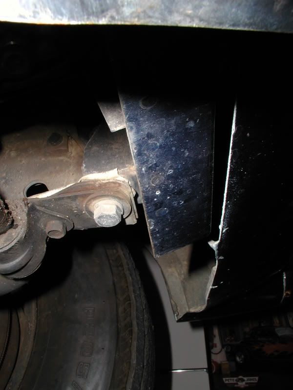

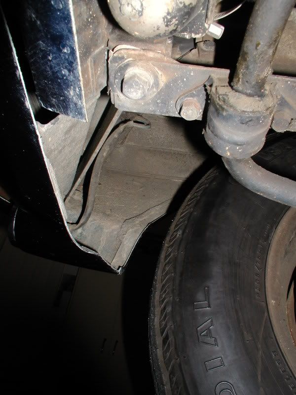

                Michael:
                I have added a couple of photos of the core support mounting to clarify how it looks. There is still masking tape holding the shims in place, so I believe everything is in it's original configuration.

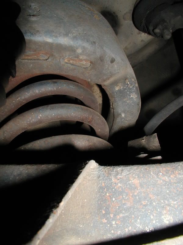

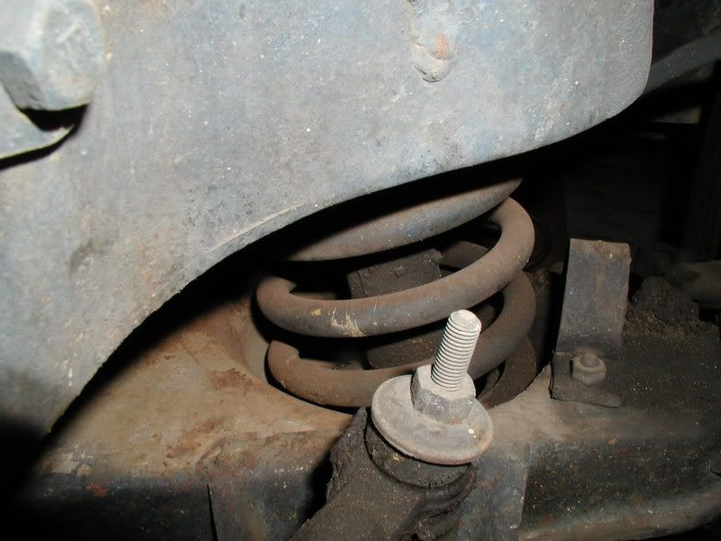

                It's really difficult to tell on the front coils - I shot a couple of photos to show what's there. It seems like there are 9 coils, but some seem to be partial coils toward the ends.

                    Question for Todd and all else. Why is the lower a-arm bumper mounted with the bolt head underneath in pic#4? According to the 63 and 64 assembly manual it shows it mounted with the bolt head on the top side. Was this a common occurance or just a off day during assembly? My last few day of production 64 had the bumpers mounted with the bolt head on the top side.
                    Odd.
                    Cheers,
                    Craig

                      Regarding your question about the bumpers on the control arms, I cannot say why they are done this way or whether they are correct or not. I checked the other side and it is the same. As far as I know, the front end has never been rebuilt, so I assume this is the way it was assembled originally.

                        Todd,
                        I would say you are correct in looking at pic #4 all the rust and dirt appears consistent with 43 years of age. It doesn't appear to have been changed out at anytime. Just another one of those differences we all look for.

                              Thanks Todd. Excellent pictures. Difficult to tell for sure but the coils of the front springs appear to be evenly spaced just like a 63 spring. The later 64 springs are progressively wound and the gap between coild changes per coil. According to GM paperwork, this is correct. The front and rear springs in early 64's were actually 63 parts.
                              I wonder if your rear spring has ever been changed? It's quite common for this to occur early in the life of 63's as that spring design certainly had problems and many were replaced. That may explain the later style progressive spring that the car has now.
