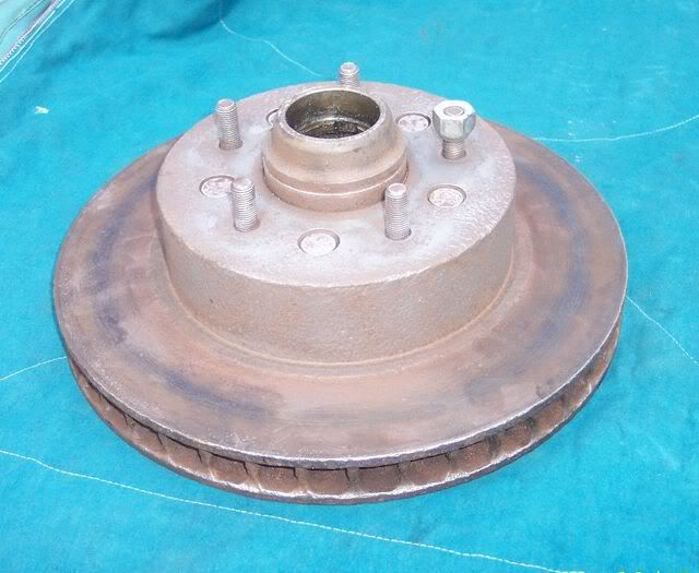

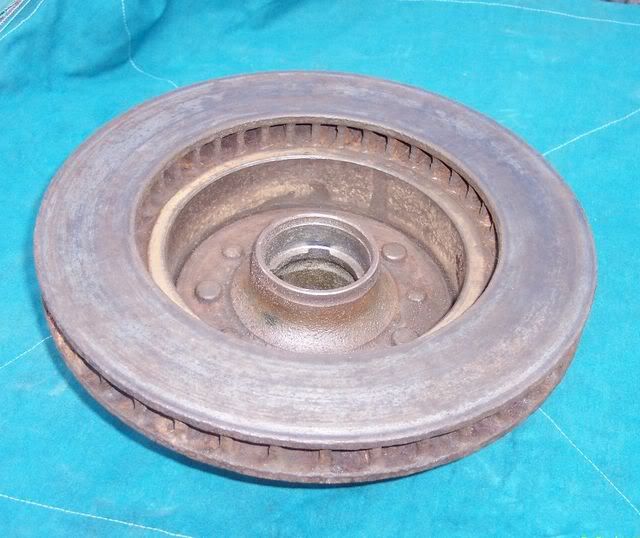

                  Here's a couple of images, front and back, which will let you see what I'm working with. The pad side surface is relatively unscathed, the leading edges of the perimeter are grainy as well as the hub of the rotor. Thanks guys.

                    It's hard to say, for sure, from the photos, but I'd say that these rotors are fine for re-use if they check out ok with respect to runout, thickness, and parallelism. I would clean up the non -friction surfaces with a wire wheel on a drill and, then, do the friction surfaces with the 3M Rotor Kit.

                      That rotor is in excellent shape and does NOT need turning. The minor surface rust will come off with either the first application of the brakes or by using the kit that Joe recommends. My rotors only have a mere 130,000 miles (compared to Joe's 200,000) and don't look as nice as yours.
