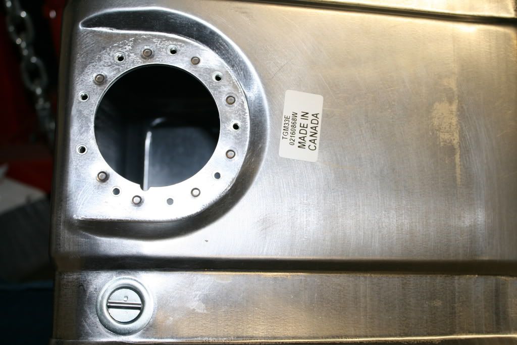

                      One more thing I thought of: are you sure that the tank that you got from Quanta had the integral pressure/vacuum valve installed? It's presence can easily be confirmed by looking at the top of the tank, about 6 or 8 inches to the driver side of the filler opening. If it's there, it will be seen as a small, round, more-or-less flat device soldered into the tank. If there is no integral pressure/vacuum valve and you used a sealed type cap, then it's no wonder that your tank collapsed.
                      However, if the valve is present AND ASSUMING ITS OPERATING AS DESIGNED, you should not expect the tank to collapse regardless of what type of gas cap you had on it and regardless of any other connections to the tank. ALL 1970 tanks should have the pressure/vacuum valve. If yours does not, then it's not a 1970 tank. Period.

                              Joe, is this it?
                              I just happen to have a new Quanta tank for a 1970 sitting in the garage waiting to be installed. It has something next to the filler opening. I assume that this is the valve. I can reach into the tank, this part is about 3/4" deep into the tank. My original tank has the same part in the same place.
