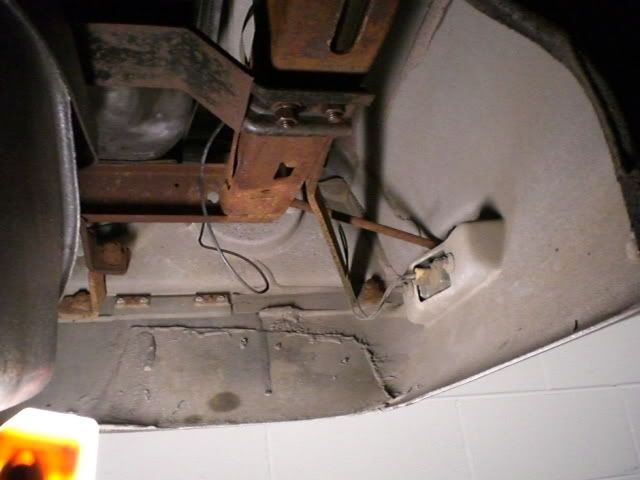

                  OK guys, the seller has now posted alot of additional photos and a little more description about the sidepipes situation. Go back to the listing http://cgi.ebay.com/ebaymotors/Chevr...spagenameZWDVW and take a look. I'm actually impressed with the car, it looks to be a quite original and unmolested example. The newly-added photos are educational in terms of seeing original components, factory finishes and overspray, etc. Whats interesting in terms of my original post about the sidepipes is the photos of the valance from underneath. You can clearly see where they were patched in, and the seller made the new description that the resin drip proves it was done at the factory. I'm not convinced about that, but I do think, after seeing the photos and the whole car, that it is entirely possible that the dealer added the pipes and did the valance patching and paintwork prior to delivery. Because it is a 3 owner car and apparently the seller is in touch with the original owner, I tend to buy the story about the original buyer wanting the pipes at delivery and that is how he got it. But in my opinion the dealer in all probability did it, not the factory.

                    ...The newly-added photos are educational in terms of seeing original components, factory finishes and overspray, etc. Whats interesting in terms of my original post about the sidepipes is the photos of the valance from underneath. You can clearly see where they were patched in, and the seller made the new description that the resin drip proves it was done at the factory. I'm not convinced about that, but I do think, after seeing the photos and the whole car, that it is entirely possible that the dealer added the pipes and did the valance patching and paintwork prior to delivery...
                    Alan, the patches in the exhaust panel are interesting...that's not the worst fiberglass body work I've ever seen from the ugly side view.
                    The interesting part is that the person used two large donor pieces of fiberglass to cover the prepped openings, by simply bonding them to the back side. Then on the beauty side, I suppose the exhaust panel has about a pound of Bondo on each side to match the contour. I don't buy that it's factory because of the "drips" either...gravity still works the same in Nebraska as it does in St. Louis.
                    I can't see the factory doing that kind of work...even for GI in the steamy jungles of Viet Nam. And if they had...I really can't see them doing it that way. But...seeing the backside does raise a question: Where did the dealer find a couple of pieces of similarly contoured fiberglass like that for donor pieces? I suppose they could make their own donor pieces with mat and resin, let them cure, then trim to fit and bond them in place...but why not just laminate them in place with something to back up the lamination?...much less Bondo that way.
                      That was and still is a common method of patching. It would not be uncommon for a dealer in `72 to have fiberglass pieces laying around. They did a lot of Corvette repair. The panel is not too good of a contour fit either and there are pop rivets too. For those that worked on them duing that time frame will remember the over counter fiberglass kits that were sold to do these repairs. That stuff was thin epoxy and ran like a crazy. The drips you see are because the stuff was thin and I would bet thats what it is. If the factory would have done this repair, they would have used the bonding agent available in the factory. That stuff has much more body and would not run like that. This stroy is BS period. Nice car otherwise though.

                          Thanks for your insights on the repairs, Wayne. I missed the pop rivets, but noted the patches seemed to not have enough curvature or something.
                          I agree, it's a nice original old car to be proud of, especially from the rocker moldings up. Underneath has been chewed up pretty good from long northern winters; it's need a good chassis resto, but it's probably BowTie eligible.
