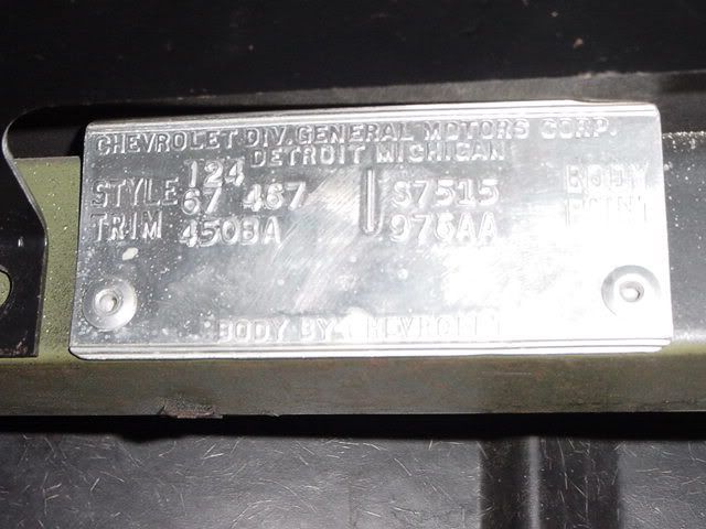

                I have a 67 Roadster that is an April car with birthday book saying it rolled off the line on April 24th. My original trim tag is dated the same day. I will try and post a photo. Body number is 67 467 S7515 dated I24. Hope this helps.
                Jace
                #28944
                • Jace H.
                  • April 1, 1997
                  • 253
                  Re: C2 Trim Tag Build Dates
                  Photo of my Tag.
                  Jace
