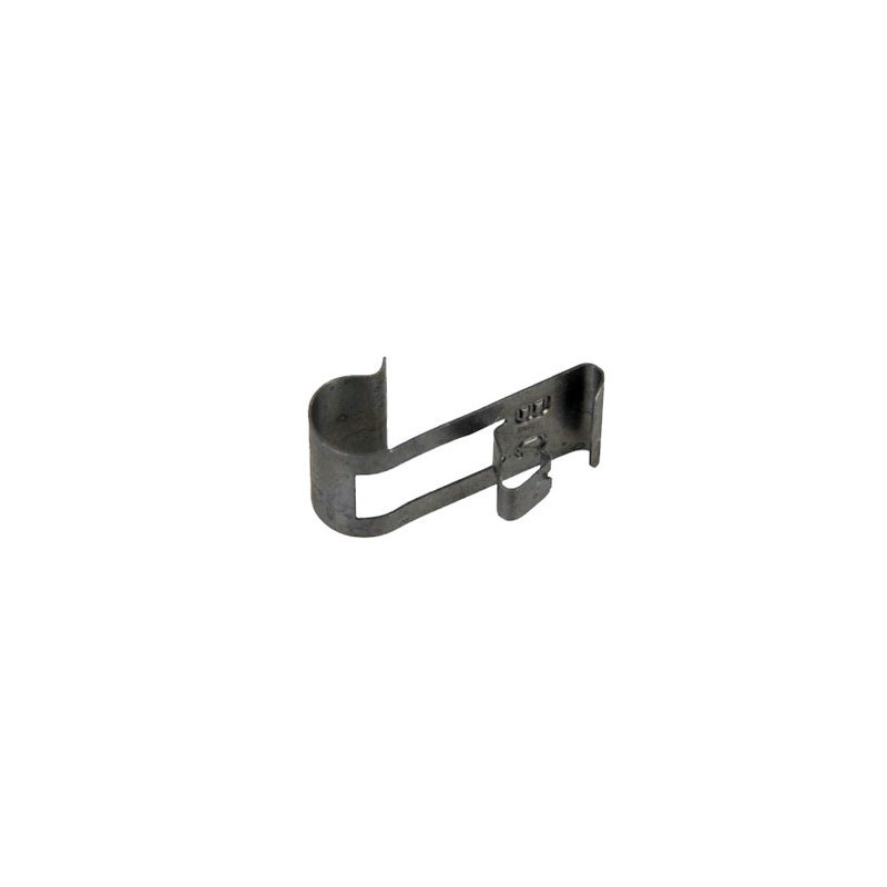

    From the AIM, I see that there are 2 "clips" that hold the overflow hose to the radiator? I can't seem to find them or where to get them. I don't even know what they look like or how they are attached and at what locations. This is a highly original car, with the original radiator.

    Here's a clue -
    they were used on a lot of GM cars, so look to non-Corvette sources to buy them, such as:
    However, even Top Flight has them:
    https://www.topflightautomotive.com/...iABEgIwHvD_BwE

      WOW, thanks! I assume these clips attach to the radiator, between the shroud and the radiator.

        Wasn't this clip on the inner fender also used?

          According to the '70-'72 TIM&JG, 6th ed, pg 202, " Through most of 1970 production, the clip is not used; instead the hose is routed through a strap attached to the inner fender panel. Very late 1970 production and all 1971 and 1972 production have this clip."
          The clip referred to here is the metal one, that often has a two-letter broadcast code stamped into it.

            The broadcast code ID tag is different than the clip.
