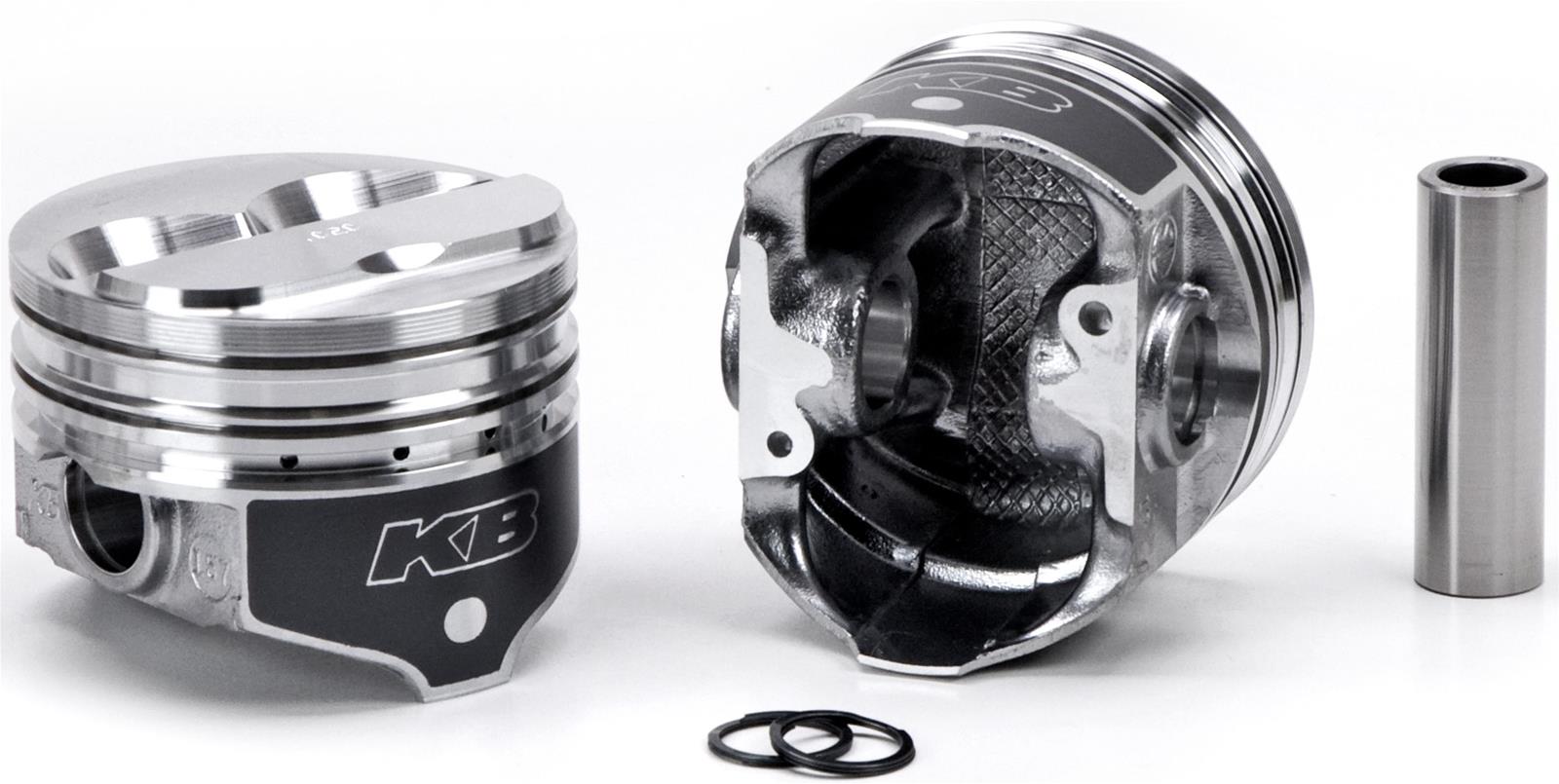

          With that, here is the KB157-STD, in stock at Summit....
          Free Shipping - KB Performance Pistons with qualifying orders of $109. Shop Pistons at Summit Racing.

            Just a reminder. KB pistons have a high mounted top ring and REQUIRE higher than normally required top ring gap - like what you find in the service manuals for OE type pistons because they run hotter due to their higher placement, so they expand more. The instructions are clearly on the United Machining Web site and likely the packaging.
            If the minimum recommended top ring gap is not obtained, the ring ends can butt, which will break the piston. A lot of so-called "engine builders" won't use them, but the problem with ring butting and piston breakage is because the moron who assembled the engine did NOT FOLLOW THE KB INSTRUCTIONS ON TOP RING GAP.
            They may require "file to fit" rings. I'm not sure but any "engine builder" worth a damn should know.
            Another issue may be the fact that they are supplied with pin retainers. They are for those who elect to use "floating pins" in the rods, something I only recommend for engines that are destined to be disassembled frequently for inspection, like racing engines. For a road engine that is intended to last for years and many tens of thousands of miles use press fit rods.
            If you use pressed pins simply discard the retainers. If you use the retainers with pressed pins you will shortly be disassembling the engine for another rebuild.
            The price is also a lot more reasonable.
