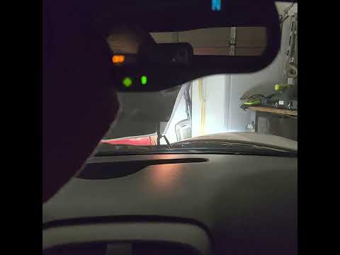

    Yesterday Harry and I were conversing about testing the Auto Dim feature of the mirror. It was 104* heat index here yesterday and I didn't want to open the garage door, so he told me how to IGN on without cranking the engine to turn on everything.
    1 - Fob is in car.
    2 - Hold bottom of "START" button(normally quick hit for ACC), down for 5-6 seconds(or more) until the dash lights up. HVAC etc may come on too if left on after last shutdown.
    3 - Proceed to test away at whatever needs testing.
    In this case, we wanted to test the rearview mirror Auto-Dim function without me starting the car.
    Here it is, yet another of my Youtube vid's showing it....... versus my typical 1,000,000 words. ....... Rich

      Rich or Harry,
      Does the blue "N" stand for "night" ?

          Hi Harry,
          No...I meant the blue capital "N" at the top right hand corner of the mirror...
            Sorry I misunderstood. That's the compass, Car is pointing North.

                  Harry, BTW, That left side on/off(0-1) switch is for the compass on or off. But if it's held in for several seconds, it disables Auto-Dim and the green indicator Lamp goes out. I bet it's in the Owners Manual somewhere.
                  Yesterday I also tested the Reverse Light effect on Auto-Dim. Putting car in Reverse will disable it. Makes sense as if backing into a spot that is lit behind you, it would otherwise be too dark to see behind you.
                  Another test I did was to pull the REVERSE LAMP fuse in the Pass side footwell fuse panel. This disabled Auto-Dim. The BCM talks to the mirror and provides the Reverse Lamp signal to the mirror, activating logic inside the mirror to disable it. If no signal(fuse pulled or malfunction from the BCM) Auto-Dim won't work.
                  Additionally, the mirror logic also controls the Driver Side outside rearview mirror dimming function, via the interior mirror forward sensor(day/night), as well as the rearward "look behind for brights" sensor . So if the interior mirror is defective, the outside mirror will likely not Dim either, depending on the fault source inside the mirror digital logic circuitry.
