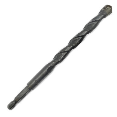

    There are some good suggestions offered above. I would add, after using a Dremel to flatten the broken drill bit, try one of these bits:
    They are designed to drill through hardened steel.

        Dennis I'll have a look at those bits. Haven't seen those before, have you used them successfully? Not inexpensive but if they work....
        Tks guys[/QUOTE]
        Yes, I have successfully used them to drill out broken drill bits. You need to follow their recommendation for RPM's while using the bits.
        They attend several trade shows and their demonstrations use these bits to drill holes in hammer heads, files, ceramic tiles, and other "hardened objects".
