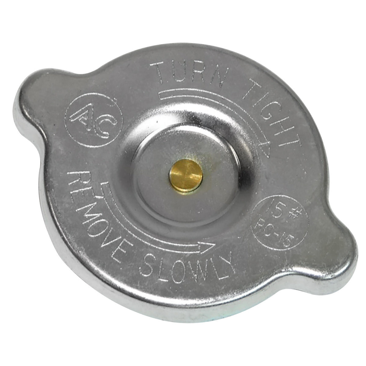

    So the cap that was on my car is totally incorrect and 7lb instead of 15lb. I have seen some 15lb ones that appear correct except the wording is different...for one thing. Instead of "Turn Tight" and "Remove Slowly" they say "Never Open Hot" and "Inspect Spring and Fall". These latter ones are GM#861050 and parts catalog confirms they are applicable for 1969...not necessarily correct for my L46 car. What Corvettes models used the 861050. The JG for 69 says nothing about these. Thanks.

    - I believe the stainless RC-15 "Never Open Hot" caps are service replacements available from Chevy in the 20th century (Joe L. can probably give specific dates).
    These are probably better than original RC-15 since they're stainless. I run one of these on the car and keep an original in the box.

        69 used a RC 15 big ear with solid rivet.
        Same as 70-72 LT1.

              Here is the original cap from my October 68 A/C car.

                Which I suppose begs the question, who made the caps originally? Gm? Or??

                  Based on the AC stamping, I'd say AC Spark Plug Division of GM,
