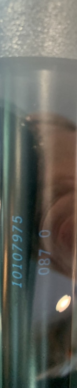

                      The attached photo is from my 1992 passenger side rear strut showing the part number and date code. The Julian date of 161 translates to June 9, 1992 which is correct for a June build date. The part number on the driver side ends in 975, All in blue ink including the manufacturer Stabilus. I hope this helps you find the codes.1992 Rear Strut.jpg

                        John,
                        Thanks for the photo. Rechecked & there's no GM part no. nor Julian date code on the Stabilus hatch struts.
                        No wonder I couldn't find the date code. LOL
                        Gary
                        NCRS Texas Chapter
                        https://www.ncrstexas.org/
                        • John M.
                          • May 31, 1990
                          • 200
                          Re: C4 Rear window support struts
                          Yes, it is hard to find something that doesn't exist Perhaps the blue ink got "cleaned off" by a previous owner.

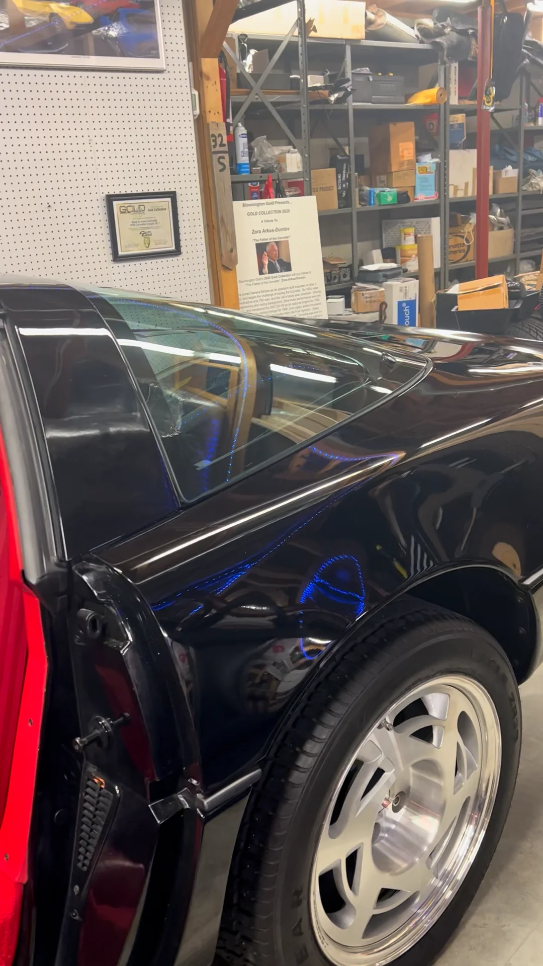

                            Dave and John are on it, correctly of course. Here is another date format for a 1990...
