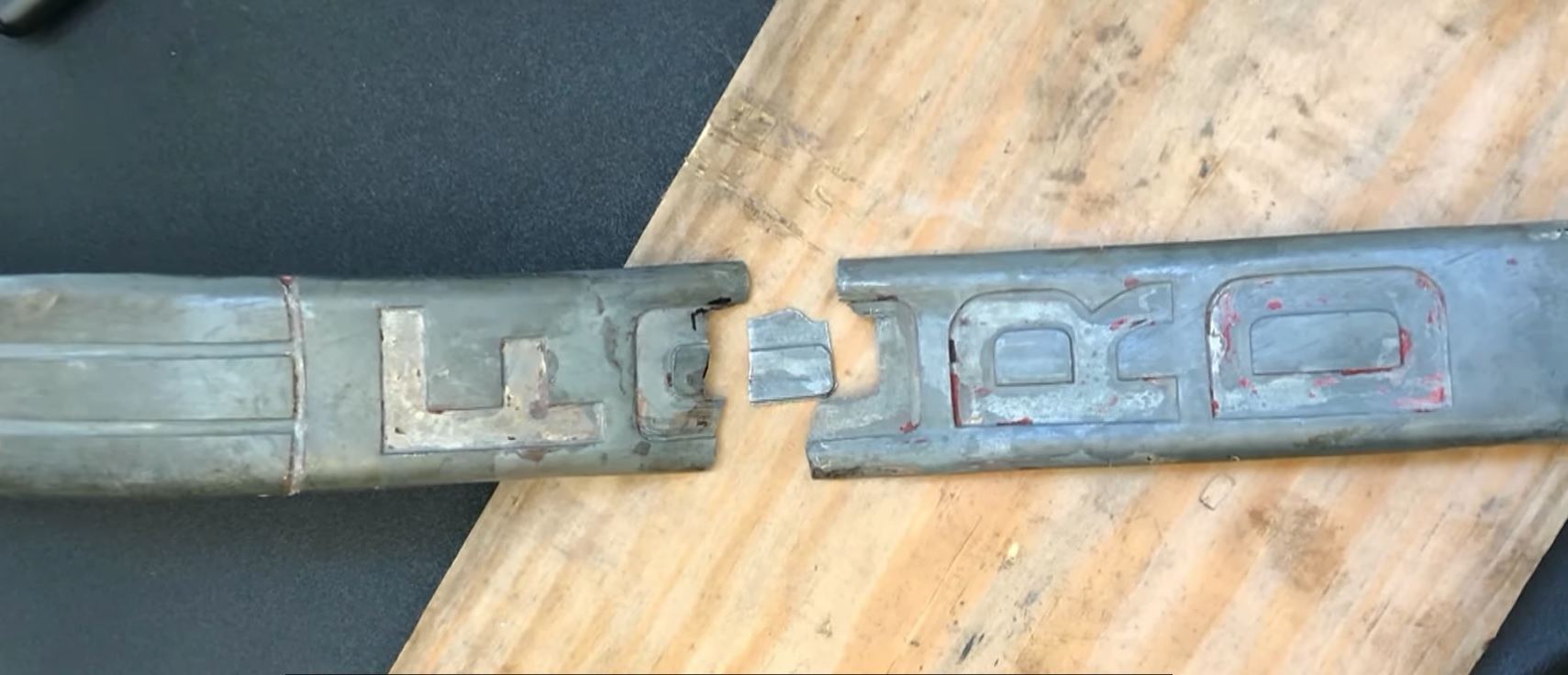

    The original pot metal center grill for my '73 has one bar broken off. I've attached a picture showing the GM part #331834 C. I called one California shop that does restoration on pot metal car parts and was quoted $165 per hour and it charges by the minute. Estimated cast to replace the missing piece and weld it would take 3-4 hours, maybe more. With freight out and back plus insurance best cost, restoration estimate is $ 550-750 to repair the grill. I'm sure I'm not the first owner that has had this issue. LH & RH grills are ok and original. I'm not looking to go with plastic replacements.
    If I just leave the center grill this way, how many points are deducted? Is it worth spending this much to repair it? It is a Florida car and was delivered with the center grill and a license place bracket for a front license plate which I did use when living in Georgia.
    Comments will be appreciated. I'm not sure if I can find an original in good condition and what will I pay for it?

    The original center grill was made using pot metal. I would think it would be cost prohibitive to have it repaired. Many of the vendors sell a reproduction injection molded piece for around $75. Keen Parts is advertising a center grill for $150 but doesn't state if it's plastic or metal. You might want to give them a call.

        Only you can determine "worth it" questions.
        As to points: there are 10 Originality and 10 Condition Points associated with "Front Frills & Hardware" for your 1973. (Link below is to Judging Sheets page)
        As described all grills are Original. Center Grill has damage and a missing piece.
        Originality is judged without regard to Condition.
        Condition is judged without regard to Originality. (At least 10% of Originality must remain in order to judge Condition. )
        Judges will spread those 10 Originality points over those elements in that line. Different judges may take different approaches to point spread, but for arguments sake, lets assign 1 point to hardware and 3 points to each of the grills.
        This judging line would be evaluated via CDCIF - Configuration, Date, Completeness, Installation, and Finish. As noted, you have a Completeness issue - part of that grill is missing. Each element of CDCIF is 20%, so deduction for missing part would be 20% of 3 points or 0.6 points. Judge will likely round that up to 1 point.
        Can't judge Condition of a missing part, but your part isn't missing - you have damage.
        Condition judging assesses difficulty of repair, etc. I'd guess you'd lose another point here as well.
        All-in-all, likely a couple of points if this is your only issue. (4500 total points in Flight Judging)
        (Not able to comment on Condition of All these parts - may be more deductions related to wear/rust/aging/etc)

          I appreciate the comments. Agree, its probably too expensive to have repaired. A few points deduction is not all that bad. I was thinking more like 100% deduction for condition. I'll put it back on and let it go as is.

            Unless item is missing, maximum Condition deduction is 75%.
            (Safety items: like tires and windshields are subject to 100% Condition deduction.)

              Do you by chance have that broken/missing piece?
              If so, there are some DIY options - see link for example type product.
              Numerous YouTube videos as well. Seems like best results when parts are being held in place via fixture of some sort.
              Never done this myself, but $$$ folks quote for repair makes you think.....
              Dave
              Pot metal repair is easy with Muggy Weld Super Alloy 1 pot metal repair kit. A Ford COE emblem is restored with a simple propane torch.
