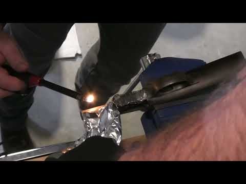

          Reluctantly, I'm going to post 2 videos.(see below) One of them a friend sent me some time ago. The other during a search for "serial number restoration". HOWEVER, I suspect this procedure may not work in your case as the base metal(frame) is very thin and you may not be able to polish the surface properly after grinding. If you attempt this I would only do it on one set of the numbers, the lightest set, as it may deem it totally unreadable. I've never attempted this process.
          You might be able to use the "liquid agent" directly on the numbers to try to enhance them but unsure if it would work or not.
