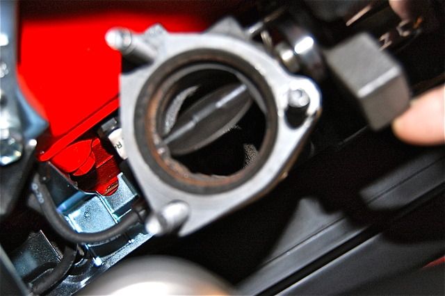

    No, that's not how it's intended to function. My first question would be, is the new one installed correctly so that it can function as designed? Was there any binding in the butterfly prior to installation? Pictures below of a "cold" closed valve and a "warm" open valve.
    Cold start...
    Operating temperature (almost...not quite fully open)
    Leif

      Thanks Leif, the arm, and thus butterfly, moves freely, hot or cold, and it is installed correctly, at least according to the judges last year at the Regional. It just will not move on its own when the engine heats up, it stays closed. I suppose a new one can be defective, but having 2 that are new and not moving have me stumped. I should have mentioned that in the '65, it was restored recently and has a new one too, I replaced the one in the '67, they look the same and neither will open when hot unless I push the arm down with a screw driver. and of course it pops back closed when I take the screw driver away. Maybe the spring is defective if that is what is supposed to open it and keep it open.
