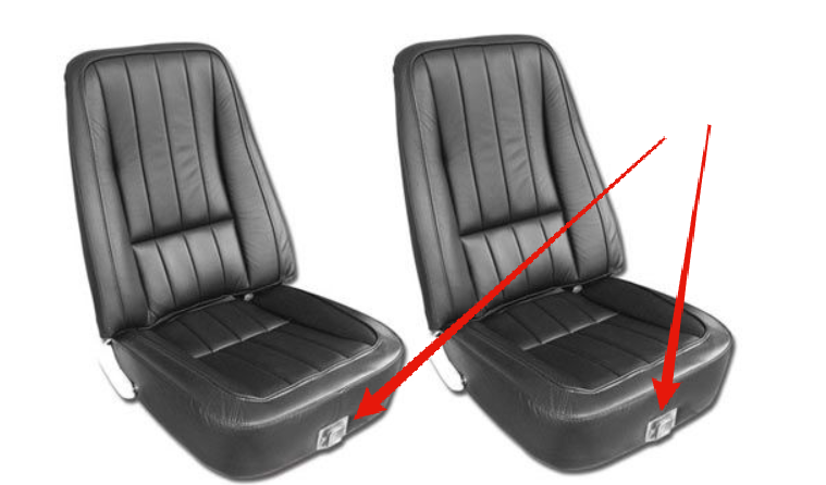

    Just getting to know my machine...wondering what these clips are on the front area of the seat bottoms. I see some cars that have them and some that dont. Is this for the "custom shoulder belts" that came with the 69 coupes (optional on convertibles) or for something else?

      I will work from my memory since my 6th Edition of the 1968-69 TIM&JG is MIA, the earliest style of these seat clips (I am sure Chevrolet found some other way to describe them) were wire in an open loop. The later style is pictured. That said, I agree with Joe in that they, in the wire form, first appeared in 1969. I believe the pictured form appeared before the end of 1969 production.
      Joe does your October built 1969 have the later style.

        My 1969 was built in mid-September, 1969 and it has the style clips as pictured in the original post.
        I have a friend who is the original owner of an October, 1968-built coupe. His car has the same style clips as mine.

          My October '68 car does not have the clips. Actually, I wish it did.

            68-69 TIM&JG Page 15, says the clip showed up after SN 9745. I've not seen a wire style clip there, but I've not seen every car and very seldom judge interior. Maybe somebody else can chime in.

              My Oct 4, 1968 build date, SN 3676 did not have any clips.

                I've not seen the wire one in a Corvette to date, but even though I judge Interior I've not judged them all as Terry would say.
                AFAIK, no one reproduces this part.

                  My memory of the wire loop style is based on a Corvette owned by a co-worker who influenced me to purchase my 1970. His Corvette was gold and either a late 1968 or early 1969 (probably the latter). Knowing what I know now I should have recorded his VIN and build date at the minimum, but we were just car enthusiasts at the time. He subsequently mover to Canada, near Toronto. Anyone know a Pete Campbell up north? I have tried Google, but the name is too common. Then too, people sell Corvettes and move on.

                      My convertible is also an 4/10/68 car, C02 on the trim tag, S/N 3407. No clips.
