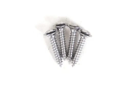

    JG says oval-head screws with captive washers are used for the parking brake console (two on each side). Is this correct? I ask because I didn't think captive washers were used.
    I trying to finish up the interior in my '70 and this small stuff is killing me...

    Zip shows what the JG says.

      Oh, yee has so little faith in the 70-72 TIM&JG. Photo from my 70, which I can't remember ever taking out. Well, since I bought it in 1980 anyways.....
