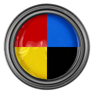

    If you are talking about fiber glass repair and tinting, I have used the pigment from Fibreglast. You mix the pigment with the resin. Use very sparingly. A drop of black in an ounce or two of resin still comes out very dark.
    Fibre Glast has pigments that can be added to polyester resin, epoxy resin, vinyl ester resin, and urethane. Colors can be mixed to achieve your desired color.
