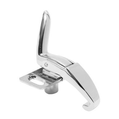

    My convertible top windshield clamp has a broken rivet. Would someone has an opinion about the quality of a new replacement clamp?

        If you are referring to the convertible or hardtop latches then I believe that Trim Parts makes a quality part. Their website says that they use original GM tooling.
        Buy 1956-62 Chevrolet Corvette Right Hand Side Convertible Top Latch, Each at Trim Parts directly from the manufacturer today.

          I've had quality issues with several Trim Parts latches. I believe they are the only manufacturer. The problem was in the base rivets. They were not staked properly and came apart when clamping the top to the frame. The top was not tight and the header was properly adjusted to the windshield frame.
          I was shocked as I recall cost then was around $125 each. I complained to them and hopefully they corrected their flaws. This was about 3 years ago. I haven't bought any since then.
          I have a loose original set here and for reference the base rivets are quite robust. On my problem repro pieces(2 of them), the latch came apart at the staked side as both rivets pulled out of the steel u-shaped bracket. I could see they were not done right. I restaked them and then were fine.

          As far as the pivot rivet goes, it looks unique. I took several photos and took dimensions of the pivot rivet using a dial caliper. The flat head is actually chromed. I'm not sure if you can get the exact rivet, but maybe something close, unchromed.
          Pivot Rivet Dimensions:
          Length: ~0.7" (after staked)
          Head Width: 0.250"
          Shaft Diameter: 0.150"
          Here are detail shots of the pivot rivet and swivel pin
          0830201527b_Burst01_resized.jpg 0830201528_resized.jpg 0830201531_resized.jpg 0830201531a_resized.jpg 0830201531b_resized.jpg
          A temporary option may be to use a machine screw and thread-locked nut until you find rivets or get the repros.
