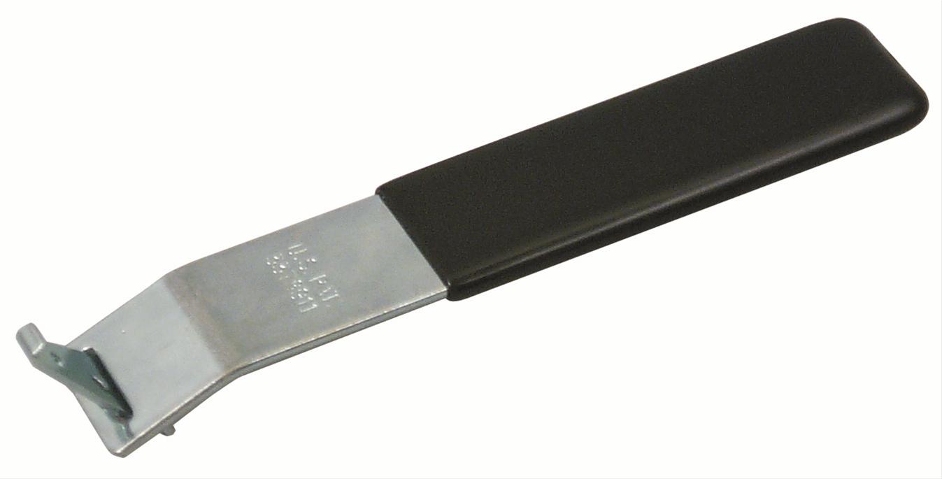

    Thanks Dave. I used a service bulletin (I think) to "bench test" the motor even though I left it in the car and the motor works perfectly which is a relief because at least I know it works. Now the problem seems to be that the RH wiper arm, although it unmistakably moves to the park position, does not recede into the cowl enough to depress the wiper door safety valve so the wiper door can close. It's as if the wiper arm isn't mounted on the shaft at the right angle, although I'm not sure if this can be adjusted.
    Anyone ever see this problem?
    Mike
    Mike
    Re align wiper arm on post - many vendors for tool, example below.
    Dave
