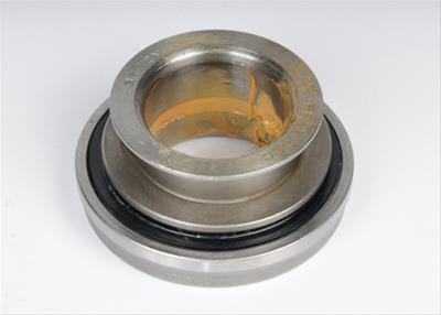

                              Re: 63 Throwout Bearing
                              Originally posted by Harry Sadlock (38513)
                              Why am I not shocked?????
                              Joe, do you have a PN for a 63 T10 front bearing. If I pull the trans and the bearing is bad I may as well have one.
                              [ATTACH=CONFIG]99610[/ATTACH]
                              Harry-------
                              I wouldn't let the the China source of the bearing dissuade me from using it. As I mentioned, this is the OEM-quality bearing. It's almost certainly manufactured by a Tier 1 supplier to the automotive industry. They manufacture very high quality parts. In fact, VERY large numbers of such components are part of brand new US-built cars, including Corvettes. So, if one is opposed to Chinese-manufactured components, don't buy a new car (or, an iPhone).
                              The other bearing, GM #19312070, I believe is manufactured in the US. However, it's aftermarket quality. For me, if I have a choice of an aftermarket quality, US manufactured part or a Chinese manufactured, OEM quality part, I'll go with the OEM quality part every time regardless of where it's manufactured.
                              By the way, when buying other aftermarket or OEM roller or ball bearings always favor a Japanese-manufactured bearing. Those bearings are the best in the world. Somewhat hard to find, though, and usually expensive.
                              The original T-10 front bearing was GM #954998. This was discontinued in May, 1964 and replaced by GM #907683. The latter was discontinued in July, 1965 and replaced by GM #907764 which was discontinued in September, 1967 and replaced by GM #907930. The latter lasted until July, 1989 when it was replaced by GM #12336440. Alas, it was discontinued without supersession in March, 1999.
                              Aftermarket replacements are available under National or Timken #307L
                              By the way, the last two 1964-74 Muncie front bearings I bought from GM, GM #907572, were made in Japan. I was absolutely thrilled when I saw that.
