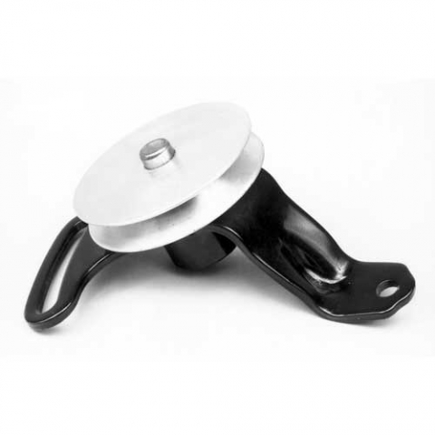

        That is interesting, and I will tell you why I have been confused for sometime on this issue, lI have been looking for a 9191 for about 5 months now, its literally the last piece of a total numbers matching NOS or Used original part restoration. I googled the 3829191 number and found a clone manufacturer. But noted he also had a complete assembly he is marketing under 3829192 which confused the hell out of me.
        So he is saying this is Late 63 through 65
        LATE 1963-1965 CORVETTE IDLER PULLEY ASSEMBLY - BLACK WITH BRACKET
        Corvette Idler Pulley Assembly With Special High Performance L63 65 / 1963-1965 / ( #17010 ) LATE 1963-1965 CORVETTE IDLER PULLEY ASSEMBLY - BLACK WITH BRACKET. 3 3/4" O.D. FOR 327 WITH 340-375 HORSEPOWER SPECIAL HIGH PERFORMANCE, FUEL INJECTION EXCEPT AIR CONDITIONING (A/C) AND POWER STEERING. GM PART NUMBER: 3829191.
        and this one is Early 63
        EARLY 1963 CORVETTE IDLER PULLEY ASSEMBLY - WITH ZINC PULLEY AND BRACKET.
        Corvette Idler Pulley Assembly With Special High Performance 63e / 1963-1963 / ( #17010A ) EARLY 1963 CORVETTE IDLER PULLEY ASSEMBLY - WITH ZINC PULLEY AND BRACKET. 3 3/4" O.D. 327 WITH 340-375 HORSEPOWER SPECIAL HIGH PERFORMANCE, FUEL INJECTION EXCEPT AIR CONDITIONING (A/C) & POWER STEERING. GM PART NUMBER: 3829192.
        Actually I am still confused

          Dennis-
          I suggest buying a good used original if you want the real deal, rather than something newly made from one of the vendors.
          The vendors write a lot of descriptions that are not accurate. I have an original in the parts box, and I don't recall there being a part no. on it. Maybe I'm wrong. Joe, do any of yours (none are for sale) have a part no.?
          I understand now. So I'm learning something. That vendor says the early 63 assembly has a zinc pulley and the late 63- 65 assembly has the steel pulley. Otherwise they are the same. Joe, or someone else, is the zinc pulley correct for early 63?

              Don------
              There is no part number on the bracket or the pulley that I have ever noted. Of course, I've not seen every one ever made.
              There is no predecessor or successor part number to the 3829191 that I can find. There could well have been a difference in the pulley finish without a change of part number.
              The vendor source linked is incorrect regarding the 3829192 being the "late" 1963 pulley assembly. 3829192 is the part number for the pulley only and is applicable to all 1963-65 with idler pulley. 3829192 is NOT the part number for the pulley assembly as shown in the link whether it be an early 1963, mid-1963, or late 1963.
