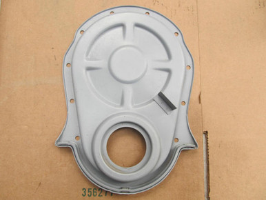

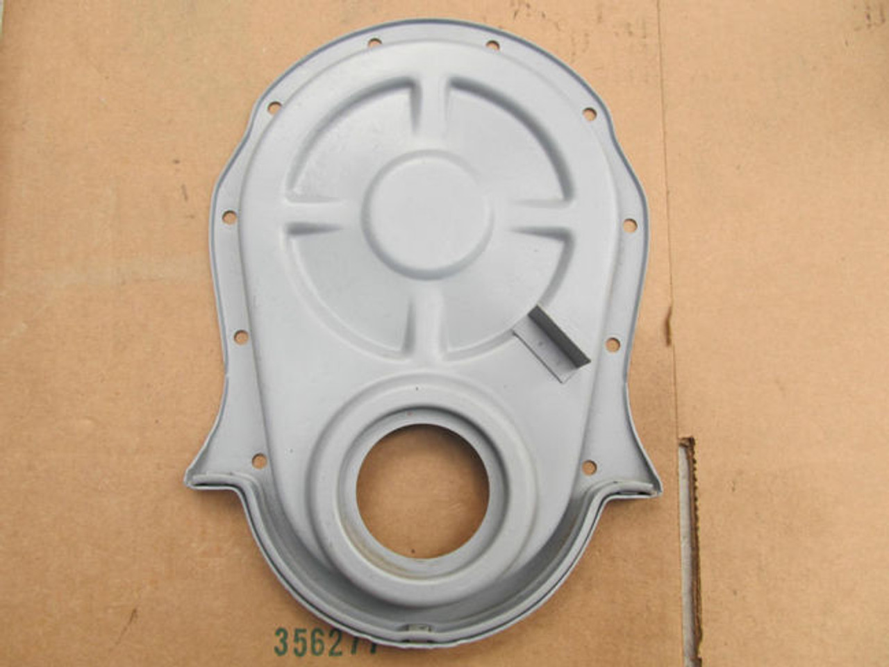

    I'm not a BB guy but this picture appears to show the weld nut you say is missing on the cover you received.
    1965-68 corvette timing chain cover BBC 427 396. FOR 7" PULLEY AND BALANCER. No dowel pin holes*PLEASE READ*Inventory of stock varies from day to day. Due to phone sales and walk in status some items might be on back order from time to time. If this
    1965 1966 Chevelle Corvette Timing Chain Cover BB 8" Balancer OE: Corvette, Chevelle, and Chevrolet Full Size 396-375hp & 396-425 hp 427-425 hp,
    What size is your harmonic balancer...7" or 8"??

        I have an 8" HB. I just purchased the timing chain cover from Zips. There is no weld nut just an 1/8 inch hole.

            What you have is a later cover which had the hole but no weld-nut. For 1967+ the hole was there but unused.
