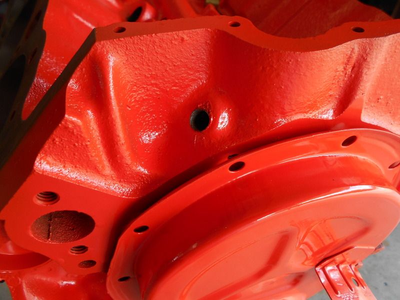

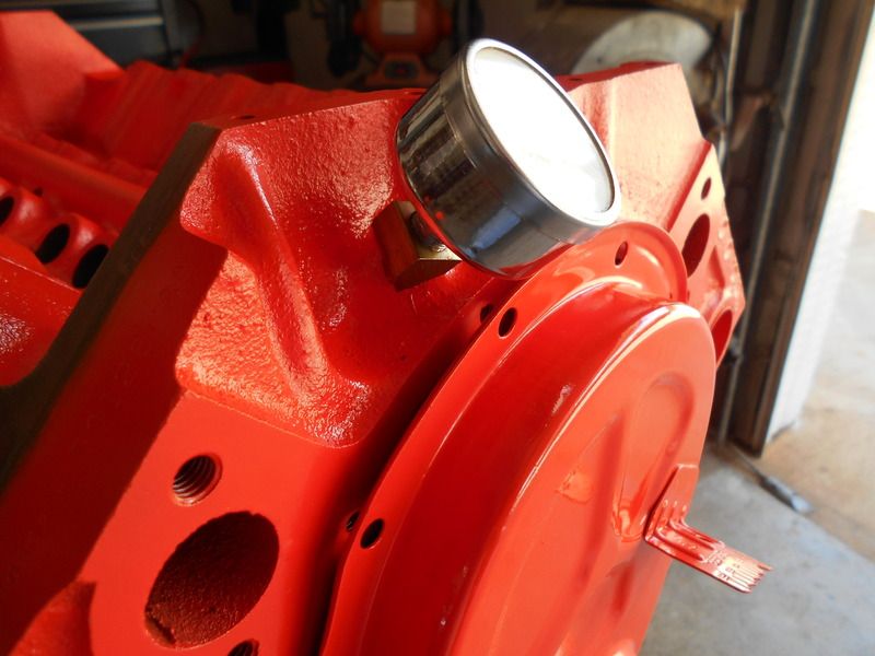

                    Without exception, EVERY small block engine I have built for the past 35-40yrs has been modified for screw-in studs and guide plates.
                    The most recent engine we built was a SB400 (and it was a 73 casting!!!) for my son's 73 Corvette. It still had its original L48 and he wanted to build it to 383. I recommended pulling and preserving the L48 and replace it with a roller cam SB400. The COMPLETE 400 he bought was virgin and in excellent shape!!! We had the 400 heads worked over, added screw-in studs, guide plates and new stainless valves, and converted it to 2 1/2in Chinese (please forgive me) copy exhaust manifolds and FULL 2 /12in system.
                    And yes, I paint the inside as well as the outside of all my engines. ZERO issues.
                    We sorta kinda tried to resemble a 70-72 LT1.
                    Plus, I add an external, OIL filled oil pressure gauge here.
                    Big block power, but 150lbs lighter!!!
