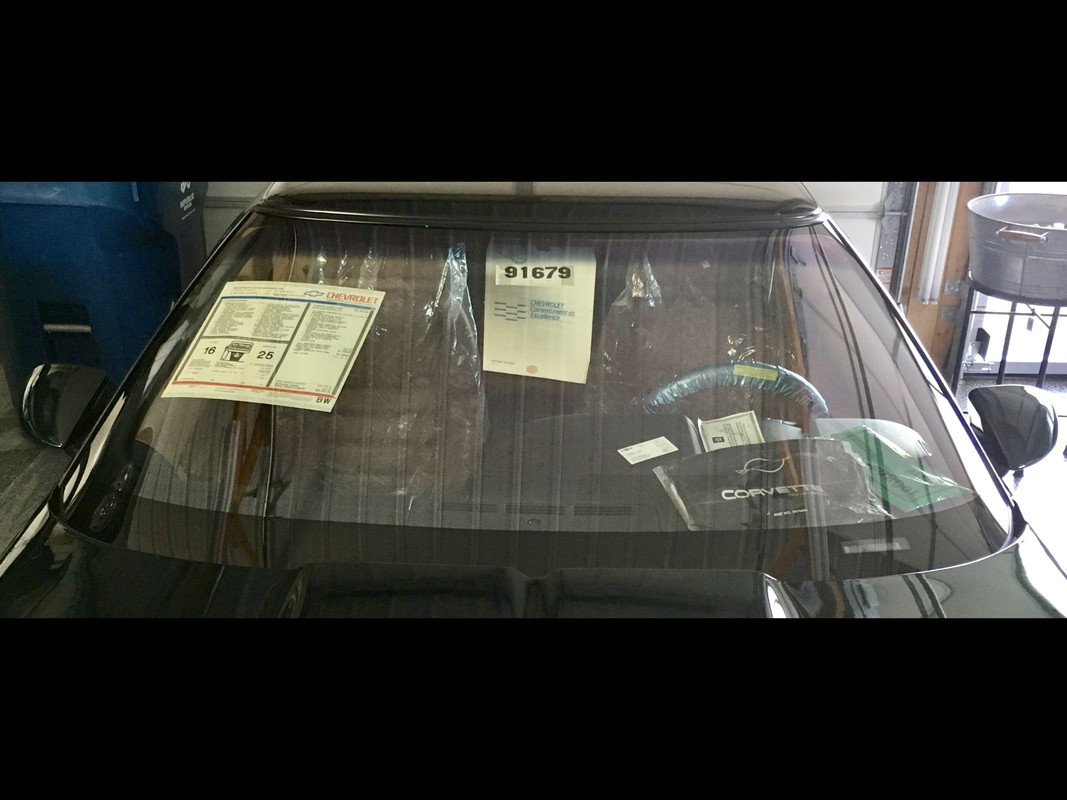

              This 90 ZR1 only has 43 original miles but shows delamination in the corners...
              Kramden
              • Steve B.
                • March 1, 2002
                • 1195
                #22
                Re: Windshield For 1992 ZR1
                Mark, that is an awesome car! Love the fact that it has never been prepped.
