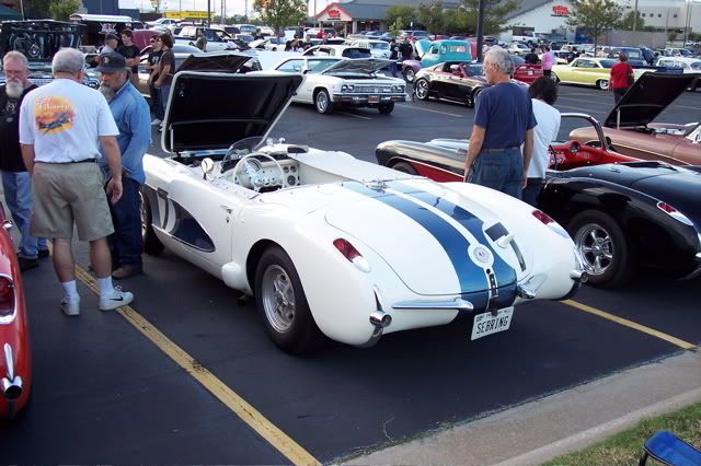

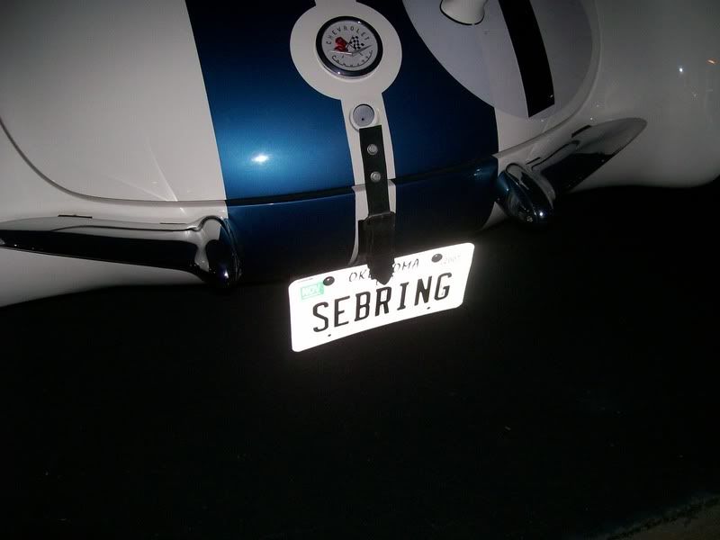

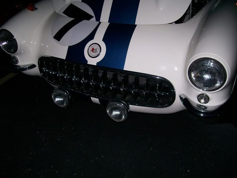

                      Many people here know John Neas, in Tulsa.
                      He has an honest, genuine 56 Sebring car which has one of the metal 37gal tanks. It is a very unique car which was modified by Chevrolet specifically for 56 Sebring.
                      I built this engine. It is a very early, std bore 56 265.
                      And this is his restored 56 SR1----------which MANY people mistakenly confuse with the 56 Sebring cars (modified by Chevrolet in Jan 56) and the SR1 cars, which were built on the St. Louis Corvette production line. The 56 SR1 cars (maybe 6 built) were optional, production cars (built May 56)-------------NOT modified cars. They did have some features which were very similar to the MODIFIED Sebring cars.
