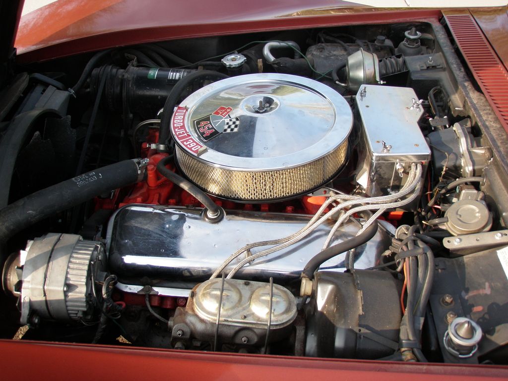

    My 70 454 with AC has a gray plastic fan shroud with no part # in the left hand corner like the black ones. I took a full dudct for a totaly incorect one at the AZ regionals this year. I saw a guy looking for the same shroud on CF with a picture of one on a AC 454 that looked just like mine. New NCRS guide has a one line sentence that said a few 70"S had a gray shroud but did not list a part #. Is there one somewhere on it. Not where I can look at my Corvette now. My VIN # is7601.

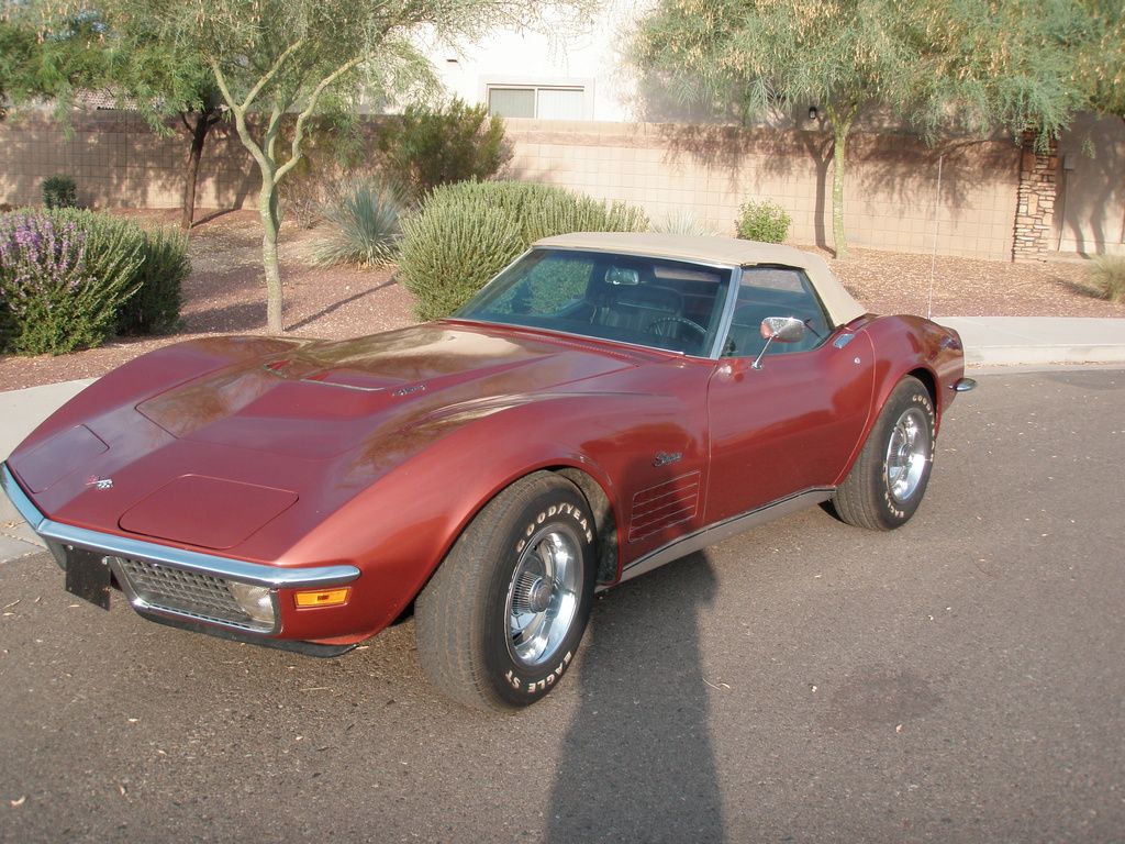

                I found a picture of your car you posted a couple years ago on Corvette forum.
                It's hard for me to tell from the picture but it doesn't look to me that you have the light grey shroud.
                Maybe that's why you were deducted on your judging sheets?

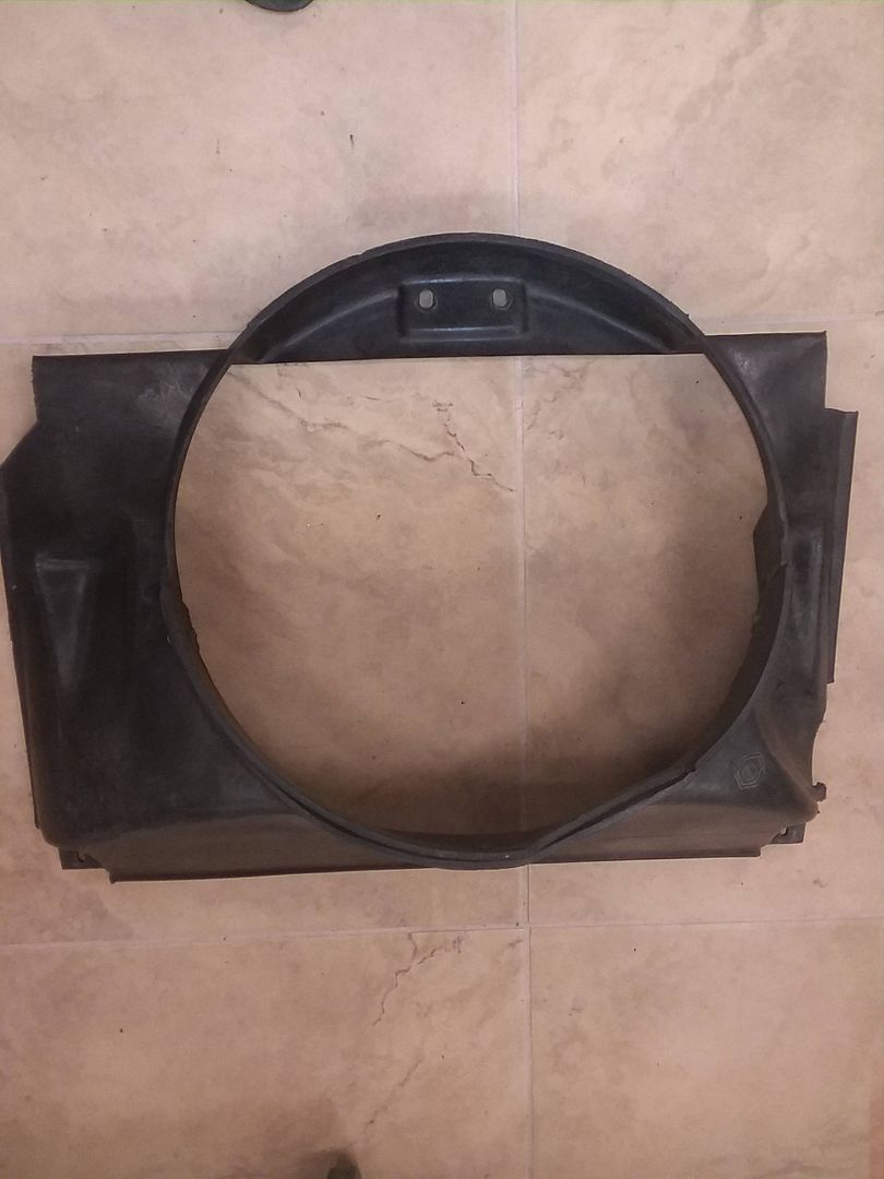

                This is the light grey shroud.

                  Is this yours?

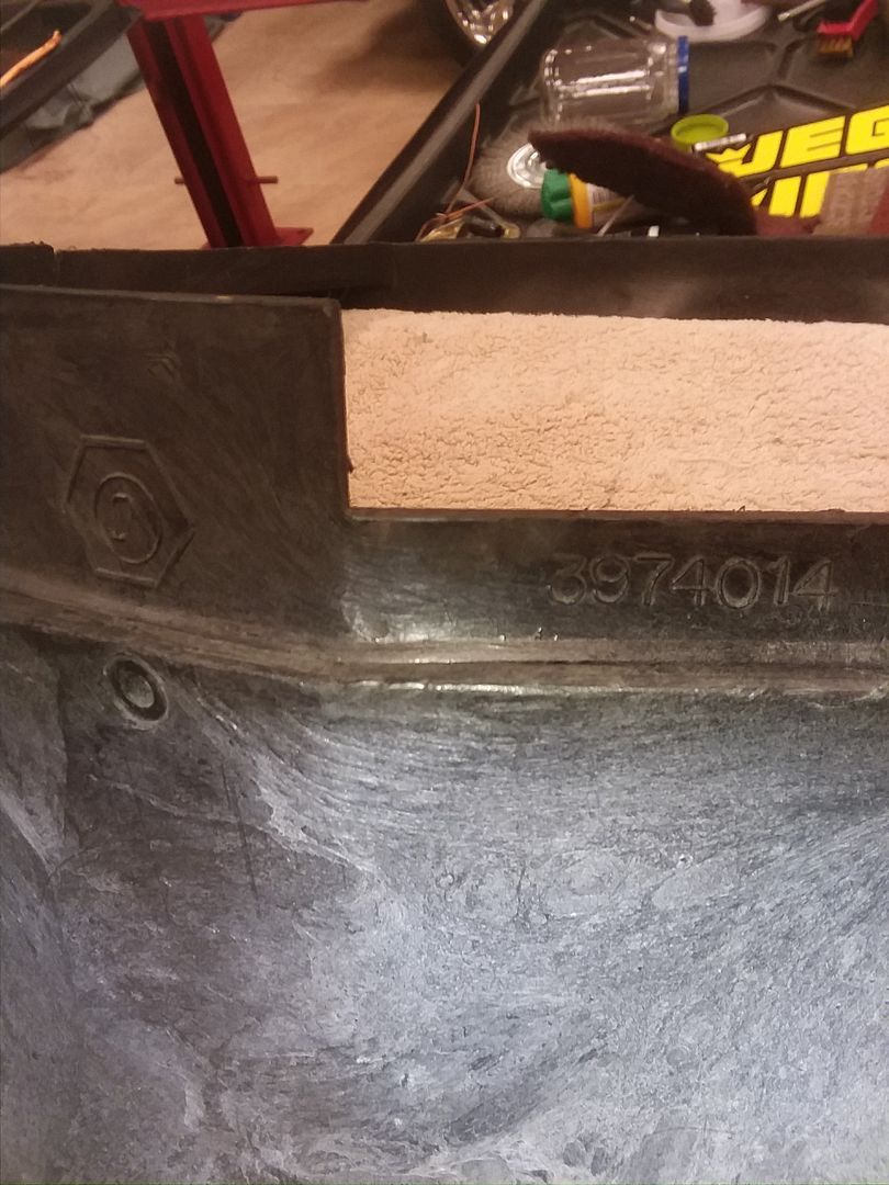

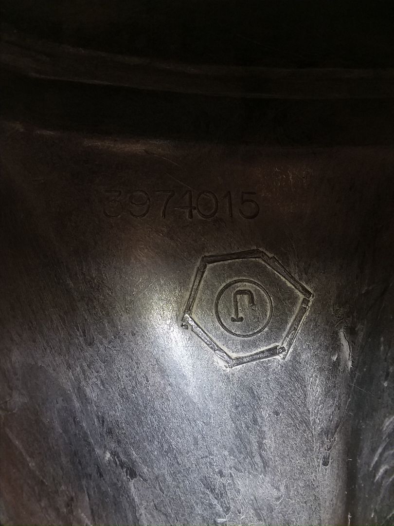

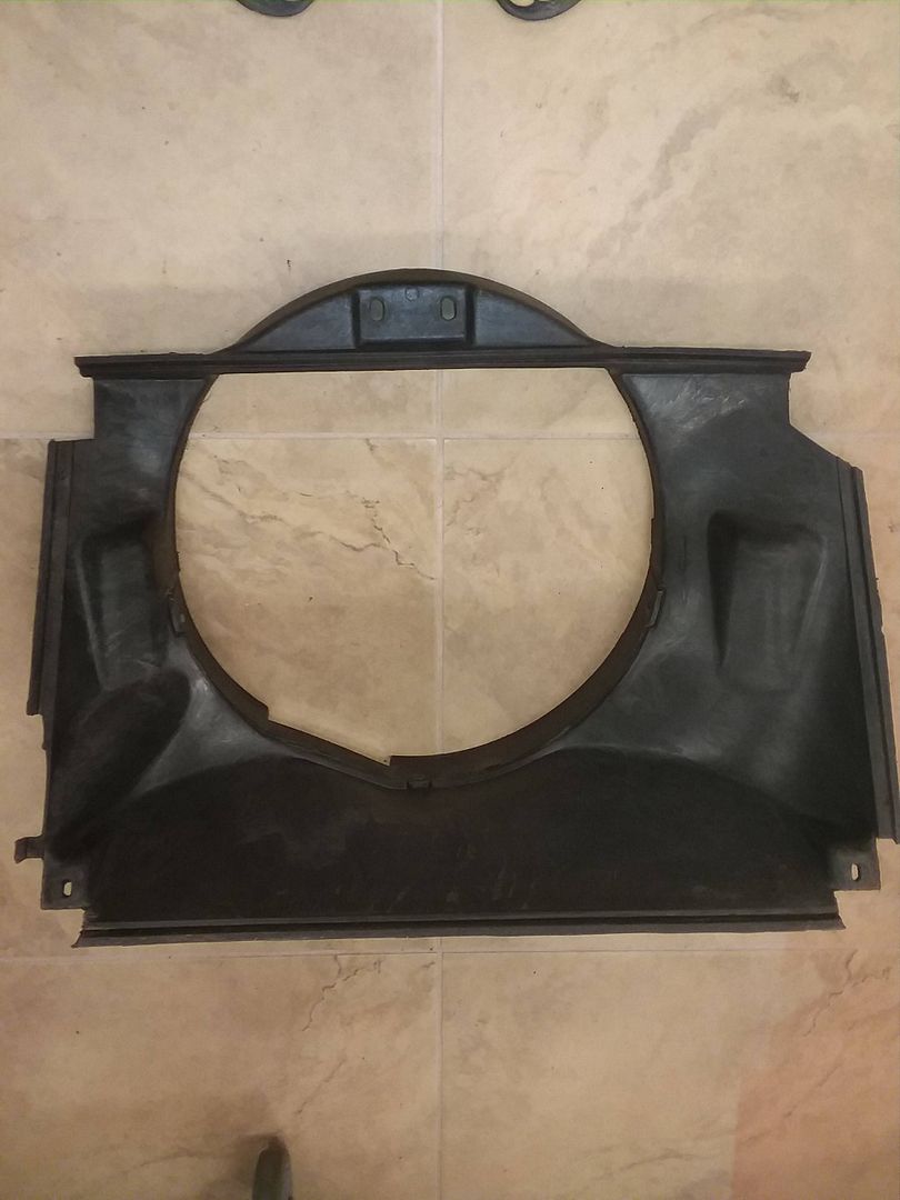

                      I have a BB convertible with no A/C built Feb 4, 1970, with 2,664 serial no. It has the 3974015 fan shroud with the darker grey color. From what I am reading above, this fan shroud should pass NCRS judging although the Judging Guide says this part number is for an A/C car. Here are some pics.

                            You would need the 119 shroud OR the light grey 4015 shroud.
                            We have been discussing at what time in the 70 model year did the light grey shroud stop being used in non A/C cars and the dark grey 119 begin.
                            Early January cars had the light grey shroud.
                            Not sure yet about February and later.
                            I have a January 27 build date and don't know for sure yet what I'm supposed to have.

                              Re: 1970 454 fan shroud.
                              The top left 119 shrouds seem to have UCC in a hexagon which I assume is for the manufacturer. Do the bottom right 4015 light grey shrouds have UCC in a hexagon or something else? My Feb 4th car has a black plastic shroud with J in a hexagon. I do not know if my shroud is original or not.
