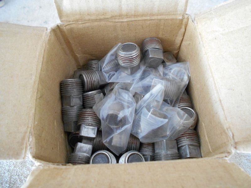

            Several years ago, I bought 100 magnetic drain plugs, nearly identical to what was once available from Chevy Parts dept, in case anyone needs one.
            • Paul D.
              • September 30, 1996
              • 491
              Re: Muncie drain plug threads
              You have mail.
