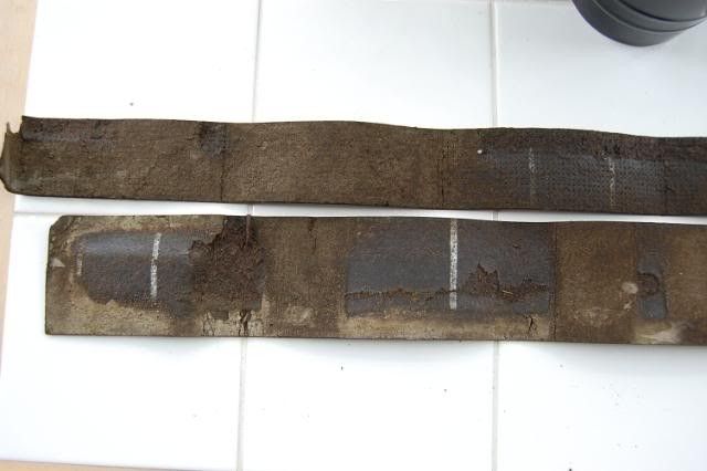

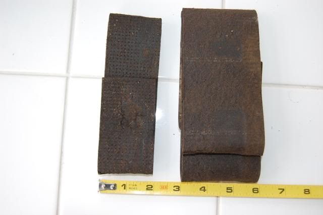

        From a very knowledgeable poster on the Corvette Forum who restored a 71 to 99.6%, I found:
        The 913 strip (rear) is 2" wide and the 804 strip (front) is 2 15/16" wide.
        And from measuring my pads, I am using 34" for the length.

          Here are a couple pictures from Alan71 on the Corvette Forum:
