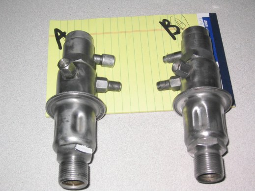

                    How are the POA and expansion valves tested on a non-working system, or if removed? Can I or a local AC shop do this?
                    The AC on my '70 worked before put into storage for 20+ years ago. So I'm wondering if/how the POA and expansion valves can be checked before evacuating and recharging. (Hoses, dryer, compressor are being replaced/rebuilt.)

                      Expansion valve. At room temperature you can blow through it. Put it in the freezer for 1/2 hour and it should close and you will not be able to blow through it. As it warms it will open and again you can blow through it. That is how I tested mine.

                        A very nice POA valve testing procedure was developed on the auto ac forum. I should have the procedure or a link. Fairly easy to do, but you need to buy/make up adapter fitting to fit the POA inlet end to a conventional R12 hose. Also an adapter to go from shop air to R12 hose fitting I have a set a friend made for me that I could loan you if needed. Shop air at 75 psig is used to test.
                        The POA can also be reset for R134a service. I have another procedure for that. Again, it came from the auto ac forum.
                        The TXV valve test procedure I have comes from AutoZone Technical library. You use an ice bath and a hair dryer to test flow thru TXV at different temperatures. Also need adapter fittings for both the inlet side and outlet side to TXV to R12 hose. I do not have these. You also make a small drilled orifice to restrict air flow for the test. I will provide a link for this test, but it will take me a few minutes to add it after I post this. So wait for it to appear. The AZ procedure contains both an on-car test and an off-car test. Use off-car one.
                        I HIGHLY recommend these tests before installing the POA and TXV valves in your system.

                            I had Original Air test both the expansion valve and the POA. I tried testing both myself but was unsure of the results. It was not worth assembling a questionable part and then have to disassemble, especially with the cost of r 12 and how tight it is to get at. The POA valve needs to be cut open to repair, which can ruin the appearance.
