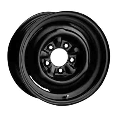

            The Wheel Vintiques series 65 is a 15X5 designed for C1 corvettes, I've had them on my '62 with my driver radials for several years. They have the nubs to hold the stock full hubcaps, brand new and true with no rust, about $105 a rim at Summit with free shipping.
            Free Shipping - Wheel Vintiques 65 Series Corvette Style O.E. Black Wheels with qualifying orders of $109. Shop Wheels at Summit Racing.

                          Thanks to everyone for their advice. After several phone calls I decided to buy the 15 x 5" rims from Summit. As they have free shipping and arrive powder coated it makes my job easier. Will go with the 205-75 x 15 tires but have not decided on a brand. As I probably won't drive more than 2500 miles per year, the brand really won't matter to much. I do like the blackwall with small hubcap look but think I will go with the 1" whitewall and full stock hubcap look. Only NCRS folks will be able to tell it is not stock.

                            I bought the 15 x 6 wheels from Summit. They don't have the nubs on the wheels to hold my full 57 wheel covers so we had to weld and work the welds with a Dremel to create them. Used the original wheels with nubs for position and size. It takes some time for good fitment. Good luck.
