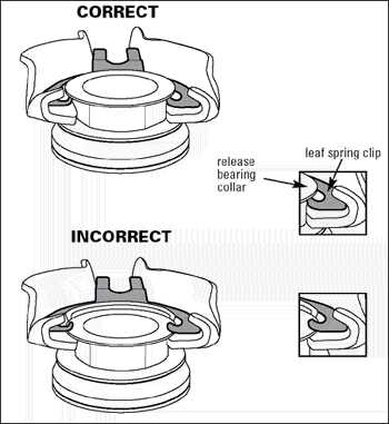

    It has been over 30 years since I've last done a clutch replacement in a C2, and my friend has all the parts....in a box and doesn't remember the position of the TO bearing in relation to the fork. Does it fit under or on top of the spring on the fork?
    Any pictures or diagrams would help me help him
    Don

          A couple of photos showing correct and incorrect throw out bearing mounting.

                    Re: 67 Throw Out bearing and Fork - Update
                    Well we got his trans out, I watched and kibbutzed, and his TO bearing is/was installed with the tangs not in the groove. So now he asked me, what are the adverse operational effects of this? I drove his car and it shifted fine and clutch was normal.

                      Well in your case the function was perfect and the life long. No worries.
                      However, it is my belief the fork is set up this way to allow full movement at the bearing pivot and retain the outer race from rotating.
                      Unwanted effects may also be excessive wear of the transmission input snout.
                      If your did neither it works both ways. Doesn't always turn out that way.
                      Don't forget to pack the recess on the bearing internal diameter with grease.
                      Rick

                        Donald,
                        If you look in the service manual there may be a picture showing the groove to lube with Molly grease like Richard pointed out. This is important and I bet lots of people miss this step, a little is all it takes.
