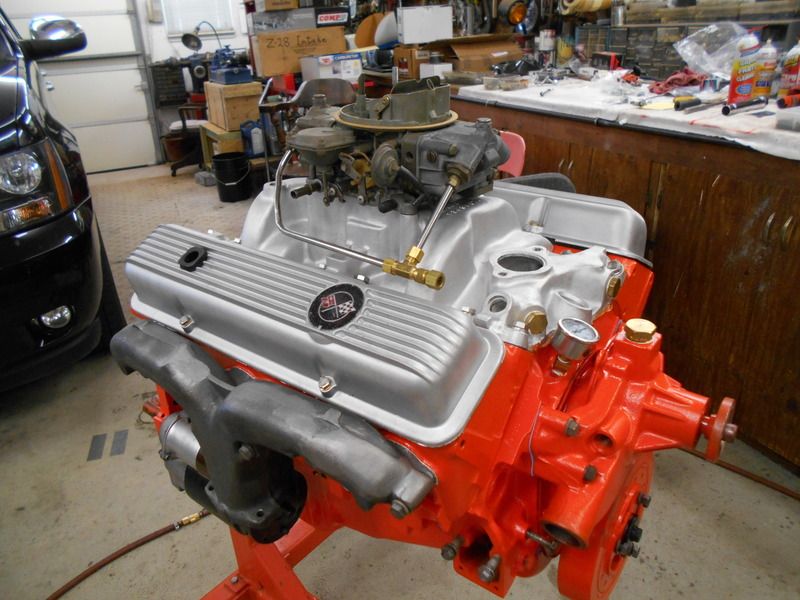

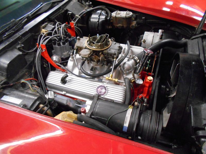

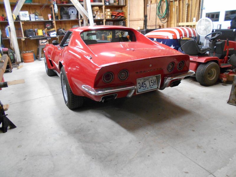

                      Last year I needed a special, one of a kind 2 1/2in exhaust system for my son's 73 which had it's original (VERY tired) L48 350/T400. No such animal has ever existed.
                      We installed a built, roller cam SB400 and wanted to go with a FULL 2 1/2in system (manifolds to tail tips), with off road mufflers. The 63-65 2 1/2in FRONT pipe will not work, because they are not formed to go around a T400. I had an in depth discussion with a CC tech guy (forget his name) and he fully understood what I wanted to do and said there was no such ex system like we wanted. SOOOOOOOOOOOOOOO, I ordered a full 72 2 1/2in system with off road mufflers (such as what would be on an LT1/L82 car). I never fully understood why he recommended a 72 system rather than a 73 system??? BUUUUUUUUUUT, the forward end of the ex pipe which attaches to the manifold is 2in and then goes up to 2 1/2in back to the mufflers. Each side of the system is only 2 pieces, plus the tips.
                      When the pipes arrived, I took the two front pipes to a muffler guy that I've been using for about 35yrs. He cut off the 2in end, fabricated and welded on a 2 1/2 end to fit the 2 1/2in ex manifolds. I had a Z28/LT1 style intake and Holley in the attic plus a pair of re-finished valve covers. When built, it VERY CLOSELY resembled a 70-72 LT1 engine. VERY minor modifications were done, such as fabricating a fuel line for the Holley.
                      Bottom line--------------our mildly modified front pipes and the remainder of the ex system fit like it was installed in St. Louis!!!!!!!
                      It ain't correct, but it looks as if Chevy did it.

                          Paul,
                          IT IS MY UNDERSTANDING, that if my son's 73 was a 4sp car, then 63-65 style 2 1/2in FRONT pipes could have been used. But I was not going to go out and buy a pair just to find out.
                          I checked on using 63-65 front pipes with everyone I knew would PROBABLY be knowledgeable-----------------it was unanimous that they would work for a 66-later 4sp car, but not for an auto tranny car.
                          Thus, after LOTS and LOTS of assessing of all the pipe configurations, I concluded that the way I went above was the only acceptable option---------------------AND IT WORKED GREAT!!!!
                          Now, with all that said, I feel I had a major advantage (having the 2in piece cut off and a 2 1/2in piece fabricated and welded), because I have been using a muffler guy that is an absolute genious at bending and fabricating MANY, MANY ex configurations.
                          Just one example. There is not, and never has been (factory or aftermarket) a FULL 2 1/2in ex system for a 55-62 Corvette. I'm talking manifold to tail pipe tip. My muffler guy fabricated a manifold to tip 2 1/2in system (although, 2 1/2in will not go through a 56-7 bezel, so he fabricated 2 1/2in 61-2 style tail pipes).
