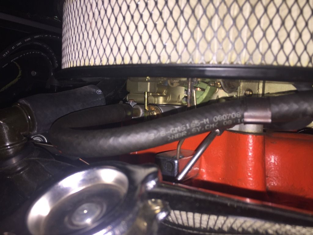

              A few photos of a 1967 390/427 PCV hose.

                You also must remember that Nolan's book did not feature ALL factory photo's. Some of them were shot at shows and swap meets. Nolan's book is the greatest Corvette book ever written but Nolan was trying to show certain things in each picture so everything in each picture is not factory 100% correct.

                  Stephen
                  thanks for the pix. It looks like the 90 is on the carb.

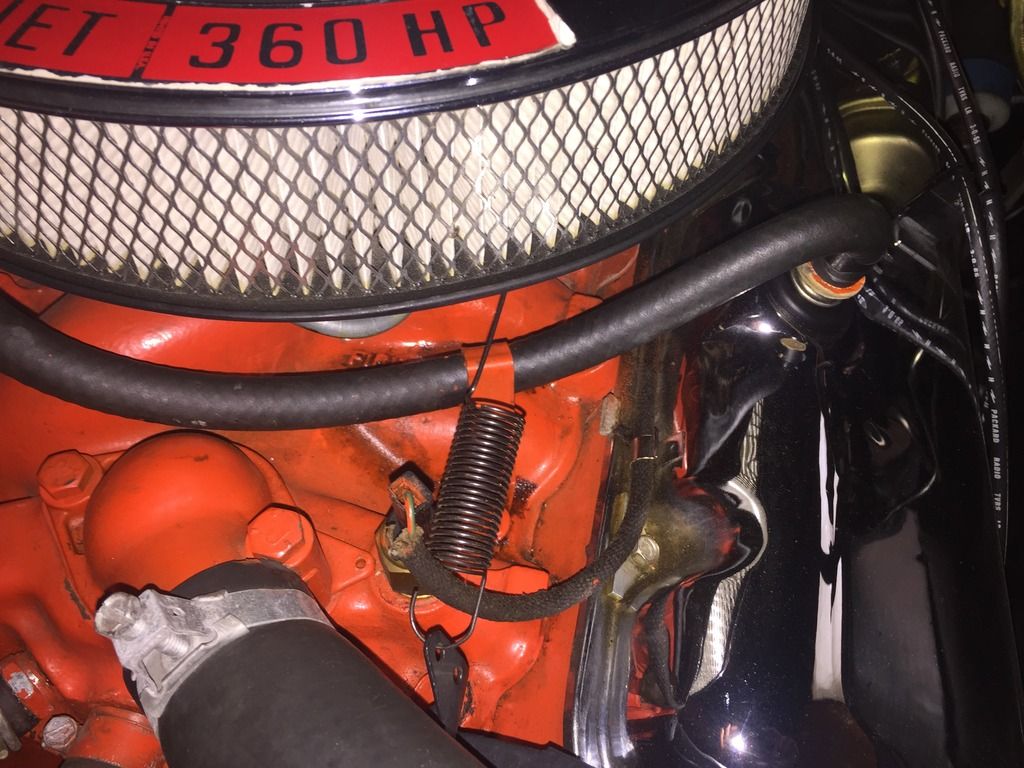

                    The 90* end should be on the PCV valve. It should clip on the manifold stand the go around and clip on the carb clip then into the base of the carb.
                    this is my 66 Chevelle 396/360 (same top half has a 427/390)

                      Keith, Your 66 396 PCV hose is fastened a little differently than a 67 Corvette L36.
                      Check out the 67 AIM UPC L36 A9. The only hose bracket is about 3 inches long (part# 3846117 item 9) and is attached to the right front carb mounting bolt. The hose has no other support brackets, as shown in my earlier post photos.
