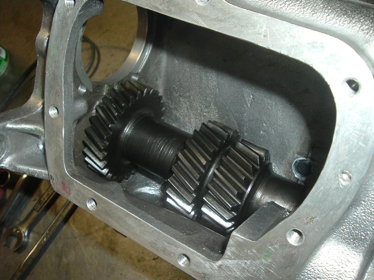

              • Gary R.
                • March 31, 1989
                • 1796
                Re: Where do these tranny french locks go???
                Mike
                No, the French locks will keep those bolts locked in place. These are through hole and oil will wick out the threads, use Permatex high temp thread sealant or #2. Here you can see inside at those holes.
