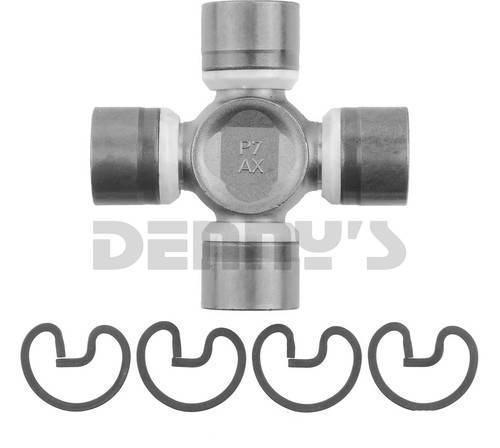

              The Dana Spicer non-greasable u-joint is my personal favorite and the last time I checked still made in the USA. Pretty darn inexpensive, as well.
              Dennys Driveshaft Corvette C2 C3 C4 u-joints for driveshafts and half shafts 53 to 96 Chevrolet Corvette 1310, 1330 and 1350 series universal joints to restore your Corvette. Greaseable, non greaseable maintenance free high mileage solid body Spicer for Racing or street car applications.

                      In my opinion, the Spicer u-joints are the best. However, their configuration is unlike the originals. I believe these are manufactured of forged powder metal. This is a very strong material also used a lot nowadays for engine connecting rods.
