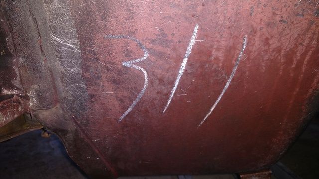

    Just wondering if anyone can shed some light on the meaning of this firewall marking on a 1967 convertible. It shows all of the signs of being a big block car, but doesn't have build sheets and not numbers matching. Any thoughts/advise is much appreciated.
    This marking is also on the rear fiberglass in front of the gas tank.
    Dave

    That's the body job number. The only thing it indicates is that it's a St. Louis car. A.O.Smith cars used a letter preceding the number.

      Thanks Jim,one less thing to think about on this project

        You may also find this number on the inside of the doors.
