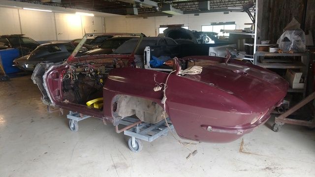

                  First time to post, figured it was time to get my feet wet here. Today, I just pulled the body off my '67 convertible and have a Corvette Image front clip that will be showing up within the next month or so. I would be happy to share my experience with the fit and finish of the front clip. As a body man, I've worked with Sermersheim's in the past and they are top quality pieces.
                  I spoke to the people at Corvette Image and they have assured me that they've resolved the issues they've had in the past and I felt confident enough to make the investment, so I will let you all know.
                  Until next time. . . Dave
