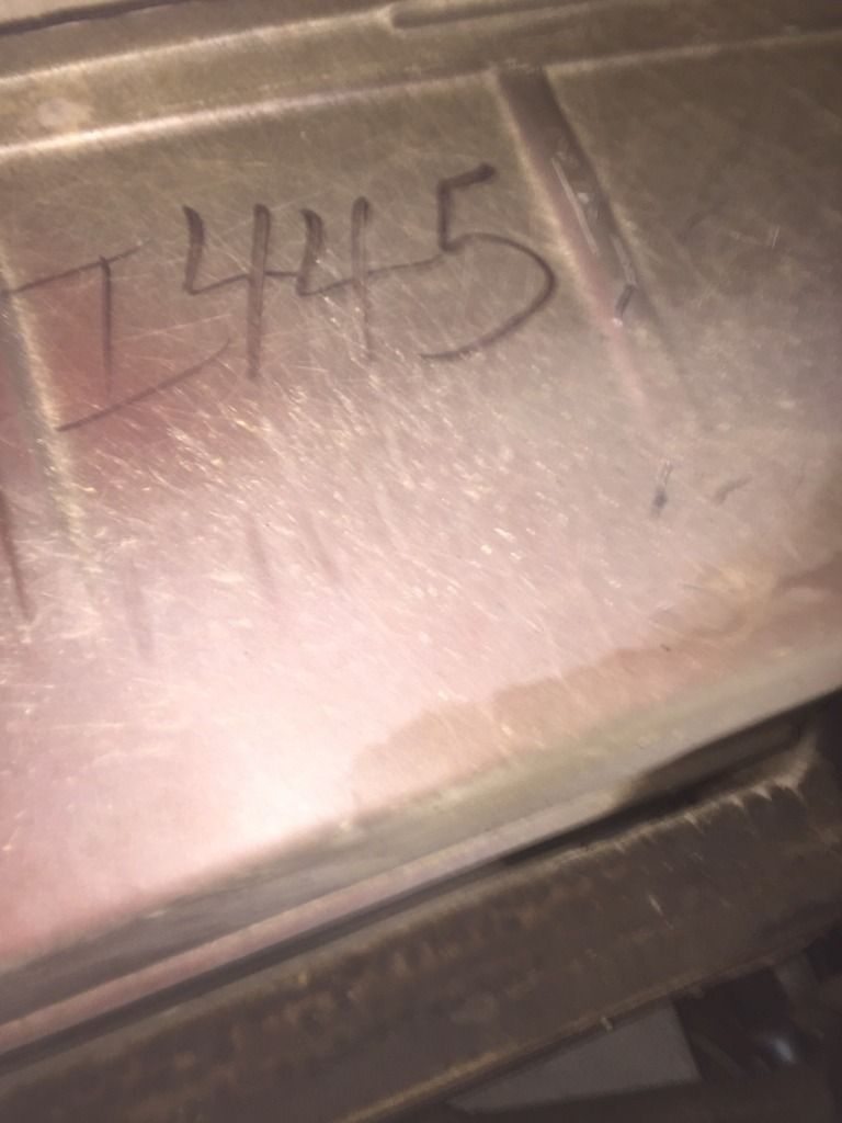

          as stated A.O. Smith used a letter before the job number that went from 1-500. not sure what the letter stands for. here is one from a feb built 65 from Smith
          but strange they forgot the letter and last digit on the luggage stop

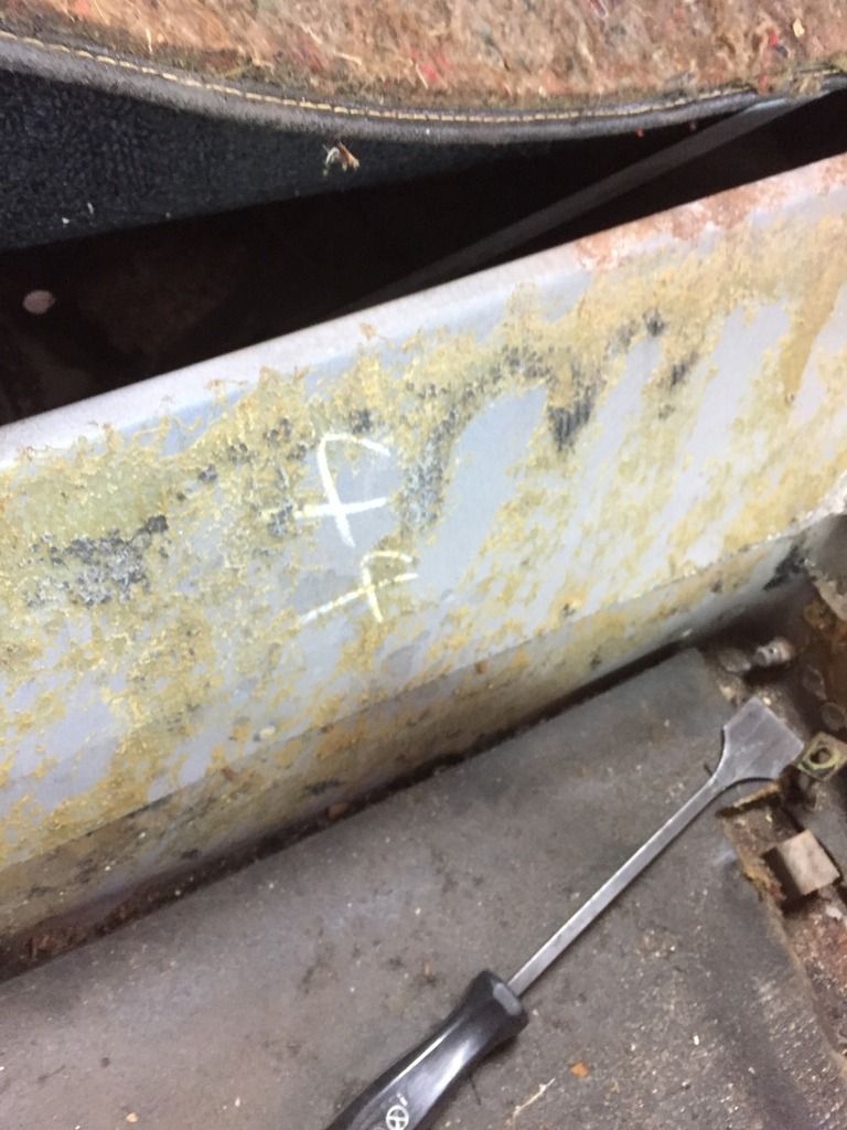

                Also check on the outside passenger side foot well for the body/job number, under the blackout, like my '64.....
