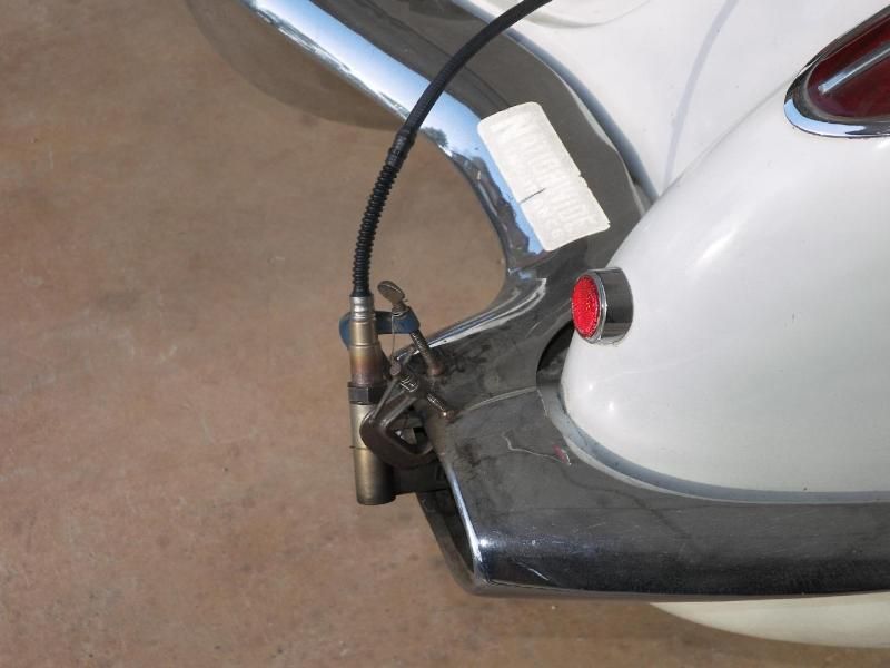

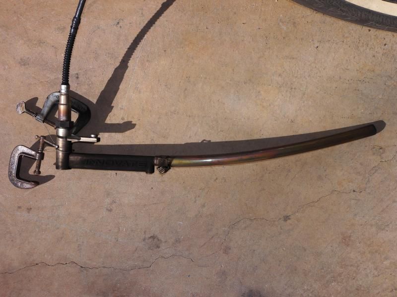

                  I appreciate the flowers, Jerry. The calibration set-up I use may not be practical for a one-time use. I justified it because I use it frequently to calibrate FI units.
                  There is a wide band O2 sensor which sits in the exhaust stream:
                  In the passenger compartment, I have a digital air/fuel ratio gauge and a small netbook computer. Whatever is displayed on the gauge is recorded on the netbook for off-line review. This lets me spot transients and glitches which I wouldn't otherwise notice by glancing at the gauge from time to time:
                  For a one-time calibration, paying the fee for time on a chassis dyno is the better way to go.
                  Jim
