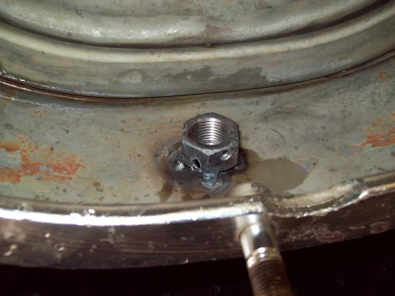

              The 56-62 housings (55-64 pass cars) are merely stamped steel. Thus, there is precious little metal for threads and it is somewhat common for the drain hole threads to eventually become weakened to the point that zealous tightening of the drain plug will produce a continual leak. Whenever I have one of these type axle housings apart, I tack weld a nut to the INSIDE of the housing to provide plenty of threads for the drain plug. Then I drill 2-3 holes in the flats of the nut to enhance drainage. No one can see it!
