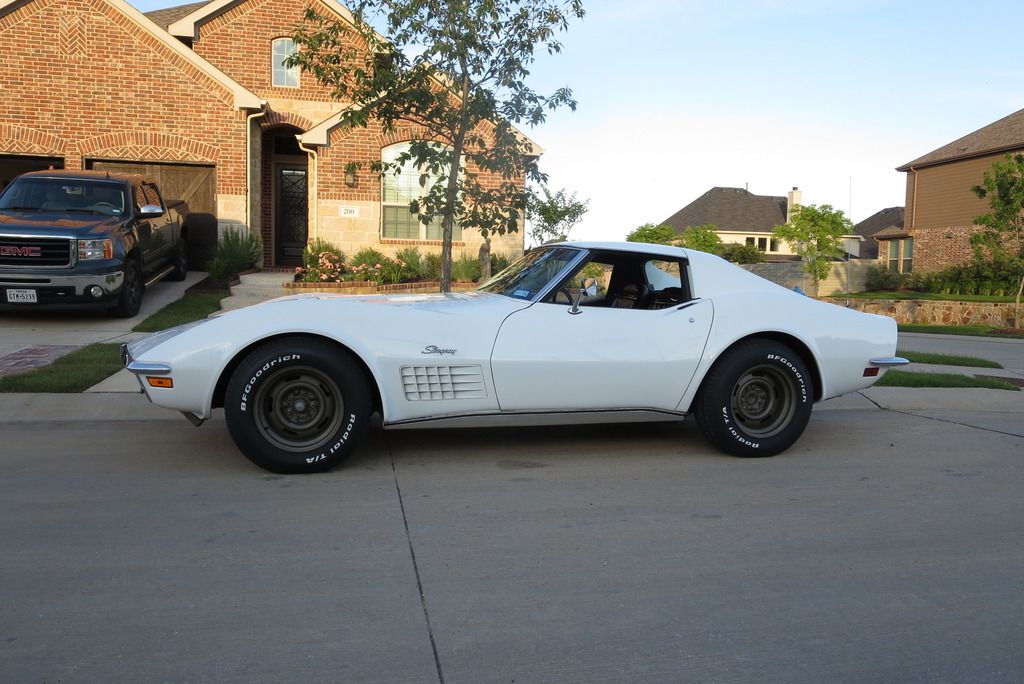

      T/As are not the best radial around, but very few choices these days in that size. I would shop around and see what else is available in that size of a radial.
      • Bill L.
        • February 1, 2004
        • 1403
        Re: Tires for 1970 LT-1
        If you want RWL tires only choices I have seen are T/As, Cooper Cobra, and Mickey Thompson Sportsman. The choices are very slim for 15" tires. I need to decide what to do on my 70 as well.
        Frankly the Cooper Tires seem like a better value. The T/As seem way over priced for such a mediocre tire.

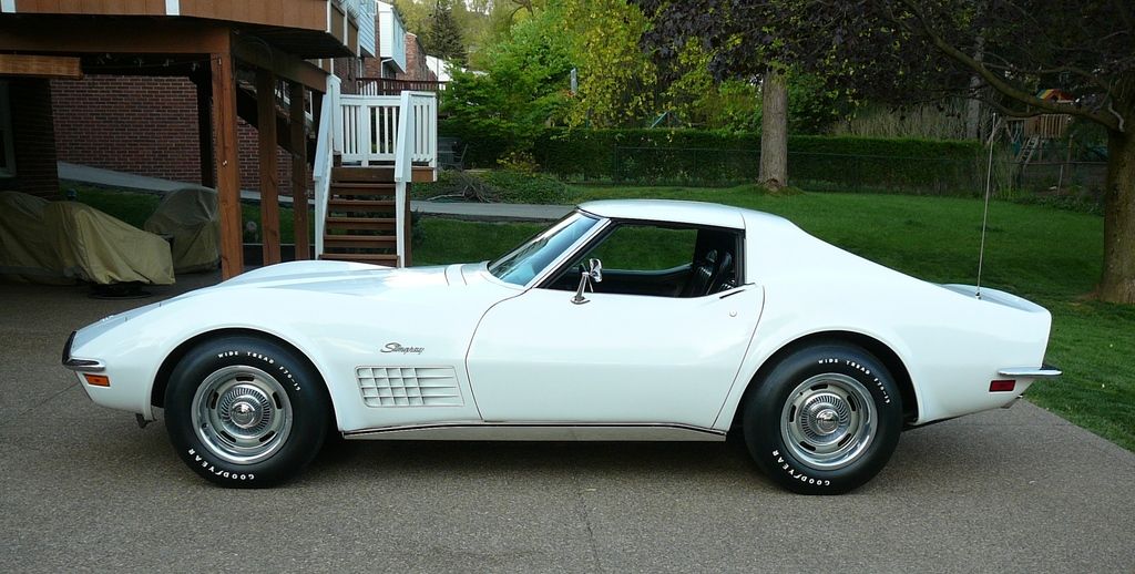

            You mention the Firestone F70-15 Wide Ovals. The Firestone F70-15 repros are not as accurate as the Goodyear F70-15 repros (tread pattern & count). If you decide to get your car judged, I believe the Goodyear F70-15 will judge better. (Can a Judge chime in?)
            215-70 White Wall, Goodyear F70-15 Wide Tread, T/A 225-70 RWL
              • 15632
              Mike is right about the Goodyears for judging, but they ARE Nylon Cord, Bias Ply (like the originals) and will ride and handle like the originals. As drivers we have become used to radial tires and modern suspension, and what was arguably state-of-the-art in the late '60s-early '70s is now the dark ages. We have become used to radial tires, gas shocks (not to mention struts) and rack & pinion steering. We can't expect early C3 or older Corvettes to handle like a new car even if all the parts are new. We have to decide if judging or driving is our goal. Tires are one place where one type does not fit all.

                Both the 215-70-15 and 225-70-15 tire sizes are an "endangered species". There are very few choices available in these sizes and I don't know of a single one that's made in above a "T" rating. Most of those available are really designed for pick-up trucks or trailer use. I believe the B.F. Goodrich Radial T/A is probably the "highest performance" tire currently available in these sizes and even it may be difficult to find as I THINK it's now out-of-production.

                  T/A's are BY FAR the worst "performance" tire on the market. I've used them because of the retro look but as many have said, "they are dangerous on anything but dry pavement with a low HP car". I had them on my Cobra and it was like driving on ice with any "spirited driving". Changed to Avon tires and it was a totally different car. AVOID T/A's at all costs.
