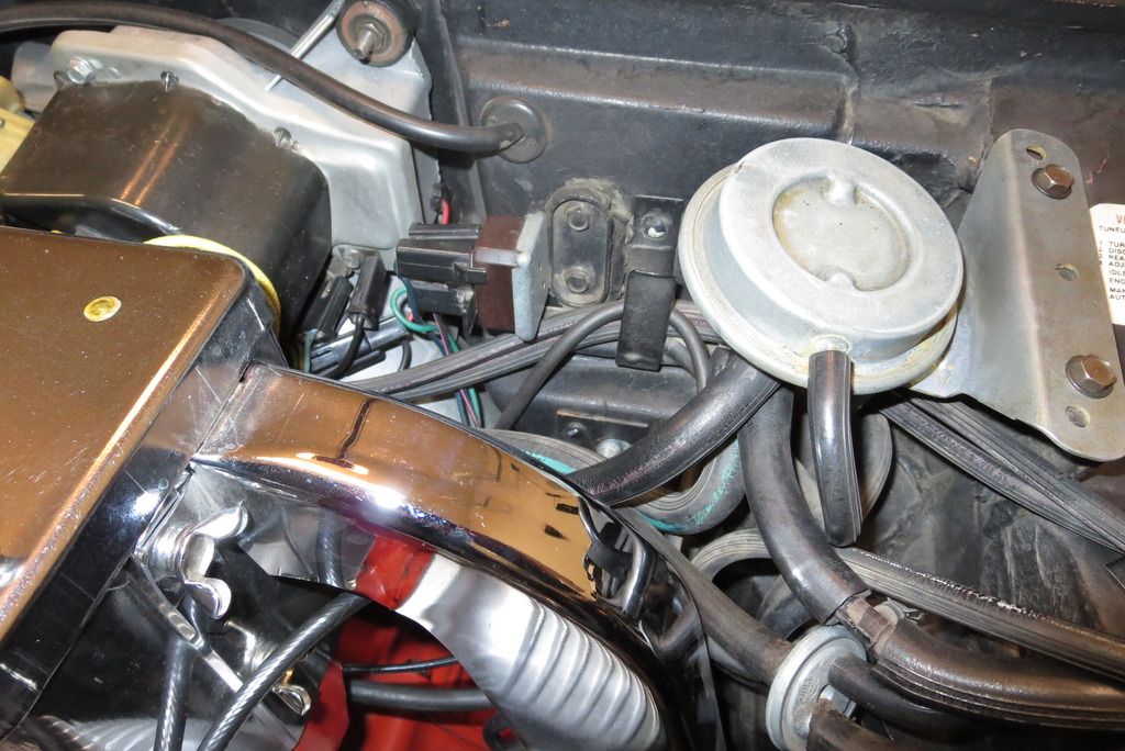

    Does anyone have a picture of the mounting location and associated hardware for the T.C.S. Relay mounted on the firewall? I was not able to determine this from the AIM. This is for a 1970 350/350 with AC. Thanks for your help.

    It attaches under the wiper arm bracket. Installs under the oval plate I have circled if this makes sense.

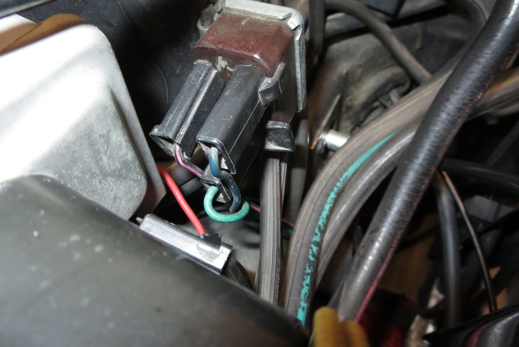

      Hi Bill,
      Mine doesn't have A/C, but here you go.

        What wires go to the relay: the blue and green 2 wire connnector in the front, the black w red, and is there another wire? Thanks.

          One wire per plug.
