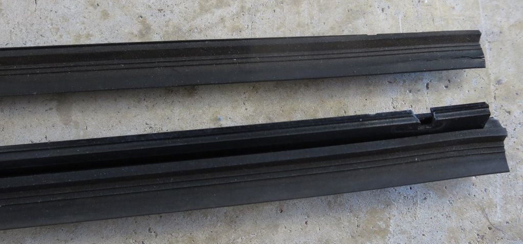

    Are these the correct wiper blade refills for a 1970?
    If so, the one is starting to split. Are there accurate repro's or is someone selling NOS?

    Mike, the blade refills appear to correct.

      Try Peter Lindahl. You can get his email through the members list on this board.
