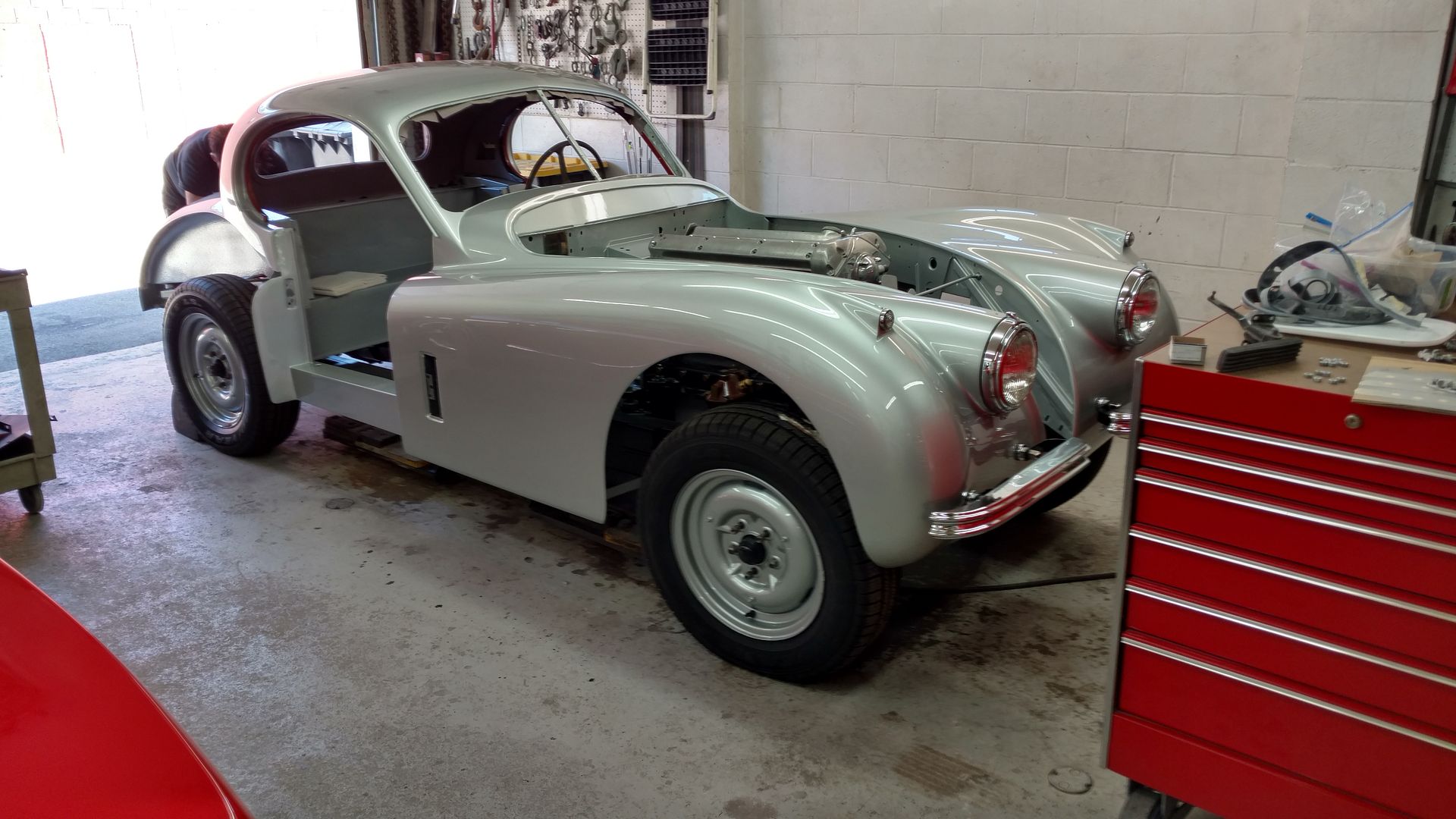

                  OMG, this isn't mine...
                  Relatively recently. It now has rear fenders, doors, and the all important 'Bonnet'.
                  How it arrived.
                  This is mine.
                  The man has done a lot of cars, and if he won't use DOT 5 in things British, well I'm not going to argue.

                      That Jaguar FHC looked far worse when the restorer acquired it. It had neither rear springs or rear end and no front wheels. Truly amazing.
                        LOL, do I detect inside knowledge?
                        Sorry for the thread drift!

                          Ed, It's all good, No Drift, all applicable...... Cool photos. See, even dead Jaguars with no engines or brakes leak stuff too. Nice job they're doing. Sorry, I thought it was yours.
