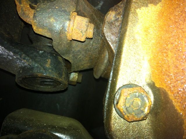

    Gentlemen,
    I've been hearing a loud metallic click from the rear of my 66 327 / 300. While driving from Long Island to Carlisle this past week I heard it while slowly backing up in a gas station after a few hours on the highway. I heard it during my next stop as well. When I arrived at my hotel I turned into the lot and the sound actually scared me. It was very loud and I'm not sure, but I think I felt the rear end of the car step out to the left as I made the right hand turn at low speed. I've included a video link showing the spot where the half shaft connects to the differential and to my untrained eye there seems to be a lot of play. I have the tire in my hand a 12 and 6 and I am rocking it. Could this be the cause of my "click"?
    Holding the tire at 9 & 3 and rocking it doesn't seem to indicate a wheel bearing issue, but again, I'm not expert.

                Yes 63-64 carriers ( housing) can be ID from external appearance. Look at the forward bracket bolts. If it's 63-e 65 those will be tapped with hex bolts in each side. If there are through bolts then it would be a mid 65-79 housing- unless the hole was drilled through for using the long bolt found in the 2nd hole back. I have done that a couple of times with 64's.
