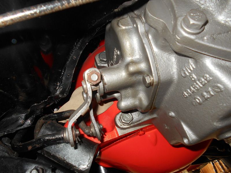

                Mike,
                Here is 1000 words. This is the 3sp linkage on the 57 Chevy.
                I can only speculate it is the same for all 55-57 Chevy pass cars.

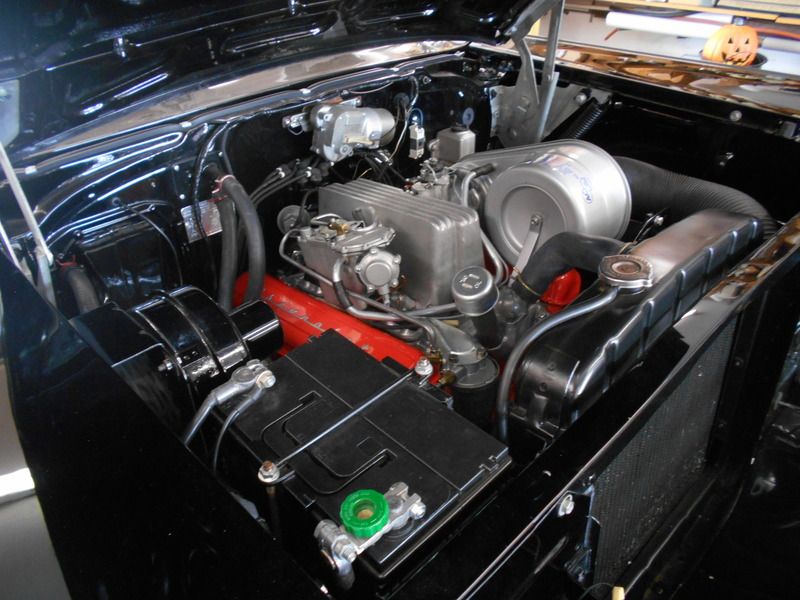

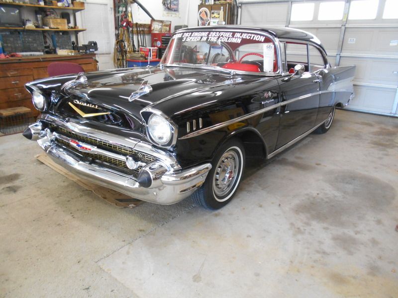

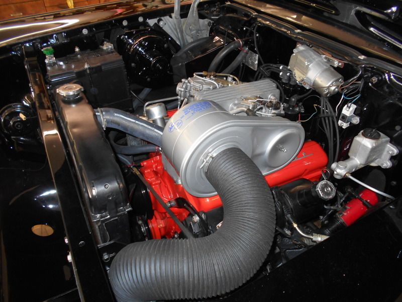

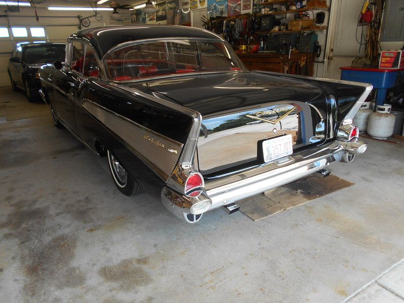

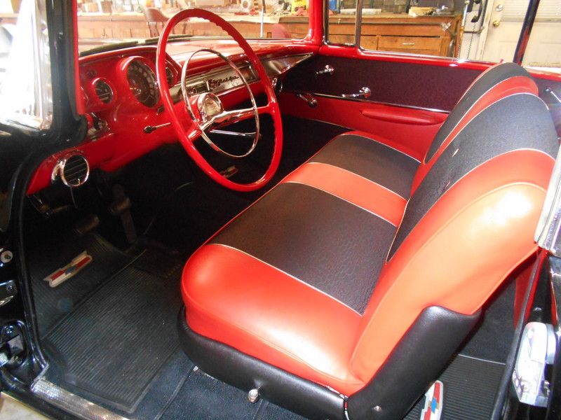

                And this is the car.

                    OK, there you have proof positive, Corvette 3sp levers were up, and pass car levers were down. Thus, as we knew (thought we knew) the notch and splines in the shifter shafts were in different positions for Vette 3spds and pass car 3spds.

                      Tom,
                      It is a rare day when I know something that you didn't! I'll mark today on my calendar. That is a VERY nice black 57.
