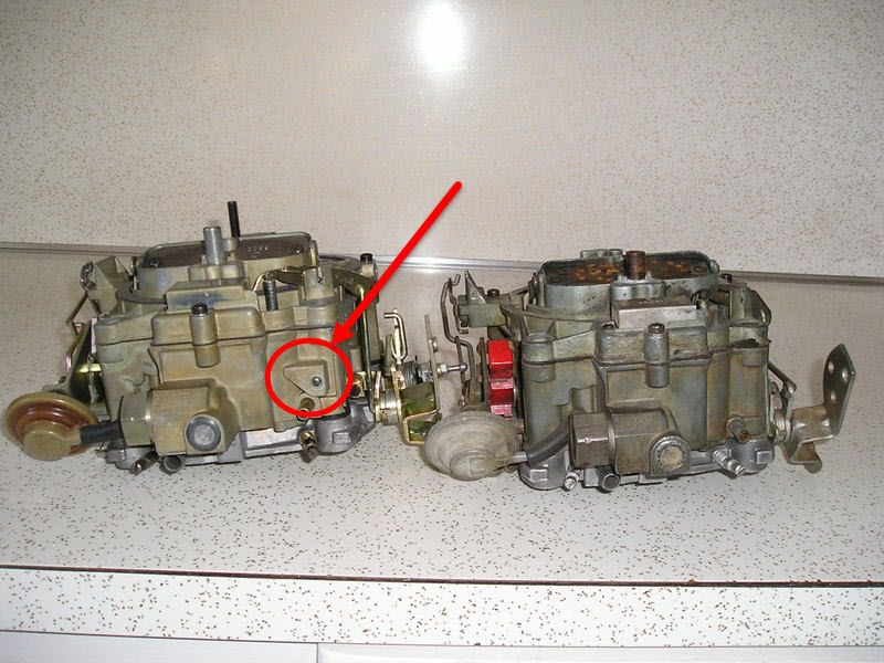

                • Justin S.
                  • July 3, 2013
                  • 291
                  Re: Original vs. Service Replacement Quadrajet
                  Mark, I was told that the service replacement carbs have a triangular casting on the front side below the accelerator pump.
                    That's interesting. I don't recall noticing that before, but I'll look for it.
                            Hi Mark,
                            Justin may be referring to a specific case (at least that I know of), though perhaps it extends to other models. At least for the 7029207 L46 carburetor for 1969, an easy tell tale of a service replacement is the triangular mounting pad for some accessory. The one without the mounting pad would be a correct configuration for this original, specific carburetor in 1969.
                            I cannot say that this is the same case for the 7042220, but I wanted to provide some clarification to Justin's post.
                              • 43212
                              Originally posted by Peter Stout (54749)
                              Hi Mark,
                              Peter-----
                              What's the date on the SERVICE carburetor shown?
